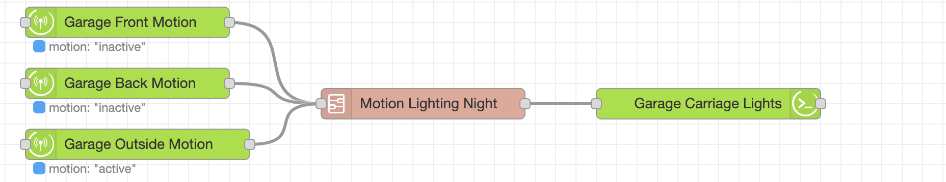

Probably a dumb question, but assuming you have that motion lighting sub-flow, and call it multiple times like maybe this one, then have it being called a few other times for different motion & different lights.
Does each flow's call of a sub-flow generate its own instance of the stoptimer? Or do they all use the same timer (i.e. they'd step on each other if you have overlapping motions and use that sub-flow multiple times)?
Each subflow has its own timer, as each instance of the subflow is a separate node/chunk of code.
Should be easy to prove to yourself, though, as when the timer is active it shows the time remaining under the subflow node (in the status text below the subflow node picture). If it was all one timer, they would all show the same countdown timer.

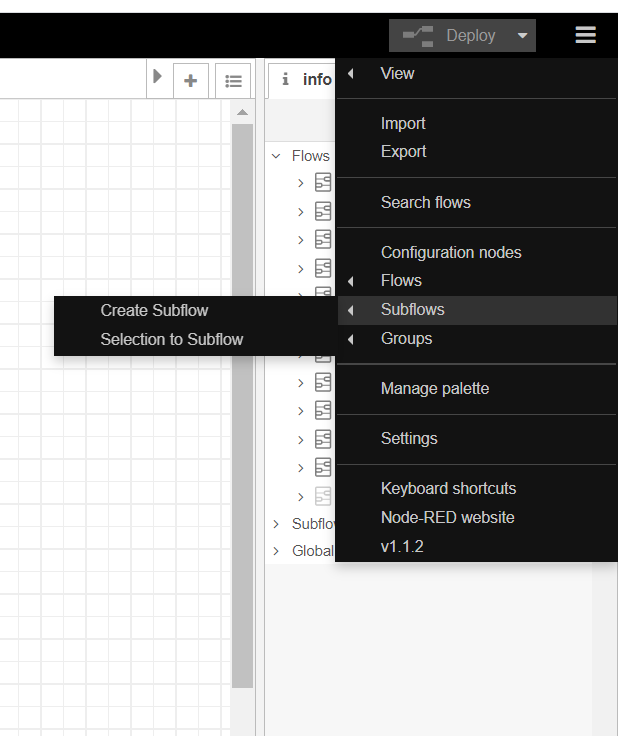

If that is a dumb question I have a really dumb question. Where do I get the sub-flow node? I have been using link in/out nodes but sub-flows an interesting approach. I did a search but cannot find it.
So you can create it from the "hamburger" menu located on the upper right of the UI "/subflows/create subflow" OR even more fun is select a group of nodes / sequence you want to use and from that same subflow submenu use "/subflows/selection to subflow"
