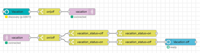

Just to diagram this out with an example. I used to have a virtual switch called vacation. When this switch was on certain rules (rule machine days) wouldn't run. Here's what I replaced the vacation virtual switch with:

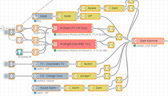

How you do deal with Lux sensors inside in the various room you have? I have something I have not figured out yet.
I have a outside lux sensor that sets a global - dark or light. I also have some rooms with lux sensors that I've calibrated on a per room basis (either light or dark). When both the room and outside lux is bright, then the lights are automatically turned off. I found an issue where the lights were turning off, because it was bright outside, but since the lights were on inside, the lux was bright. So, the lights turn off, and then 60 seconds later turn back on again. Then off again, then on again.
So what I did was add in a third condition to the lux logic. If a specific TV light is on, then it wont turn off the lights (due to lux). It will still turn off due to motion/mode/etc.
But now I'm discovering that it wont turn off even though it's bright outside and inside. It is bright enough that if the lights turned off, they would stay off, but I dont know how to work it with the logic. Once the light is on, it will not turn off until there is 20 minutes of inactivity in the TV Room, which is a high activity room in our house. (That part of the logic is not shown in the flow below).
The lux logic is centered around the 2 red nodes in the middle (dark and bright). They send a message to the State machine. The 3 inputs are lux outside, lux in TV room, and the aforementioned light. Presently, that particular light is turned off and the State Machine is in the right state, because I manually turned it off via the Hue app, and the logic worked. But I'm wondering how to do it automagically.

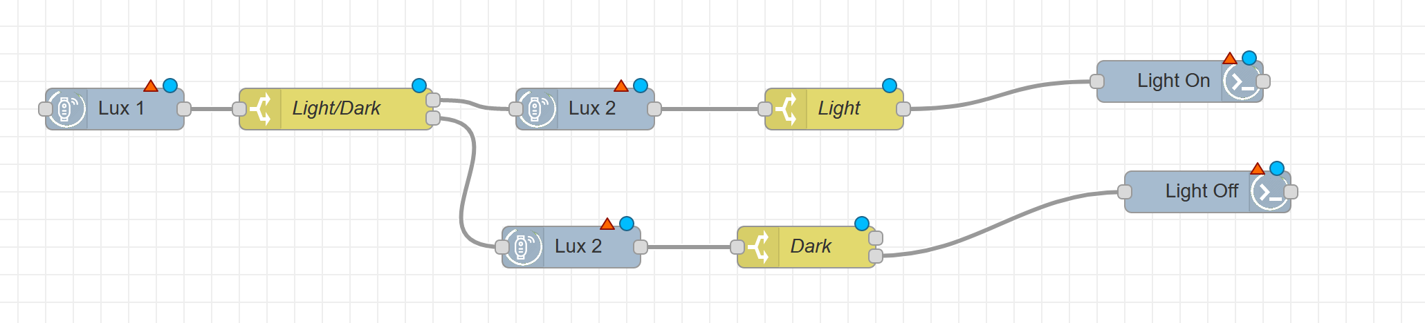

You would also need a duplicate flow with the Lux sensors reversed so the flow will trigger when either sensor changes. remember to set the lux sensors to NOT send events (unless its the first sensor in the flow) or you will have some very interesting behaviors
This is the basic method i use for my motion sensors as well to ensure the lights dont cut out because 1 of the 2 in a room goes inactive.
Not sure how well this method can be worked into your flow, we do things quite differently in general based on your screenshot.

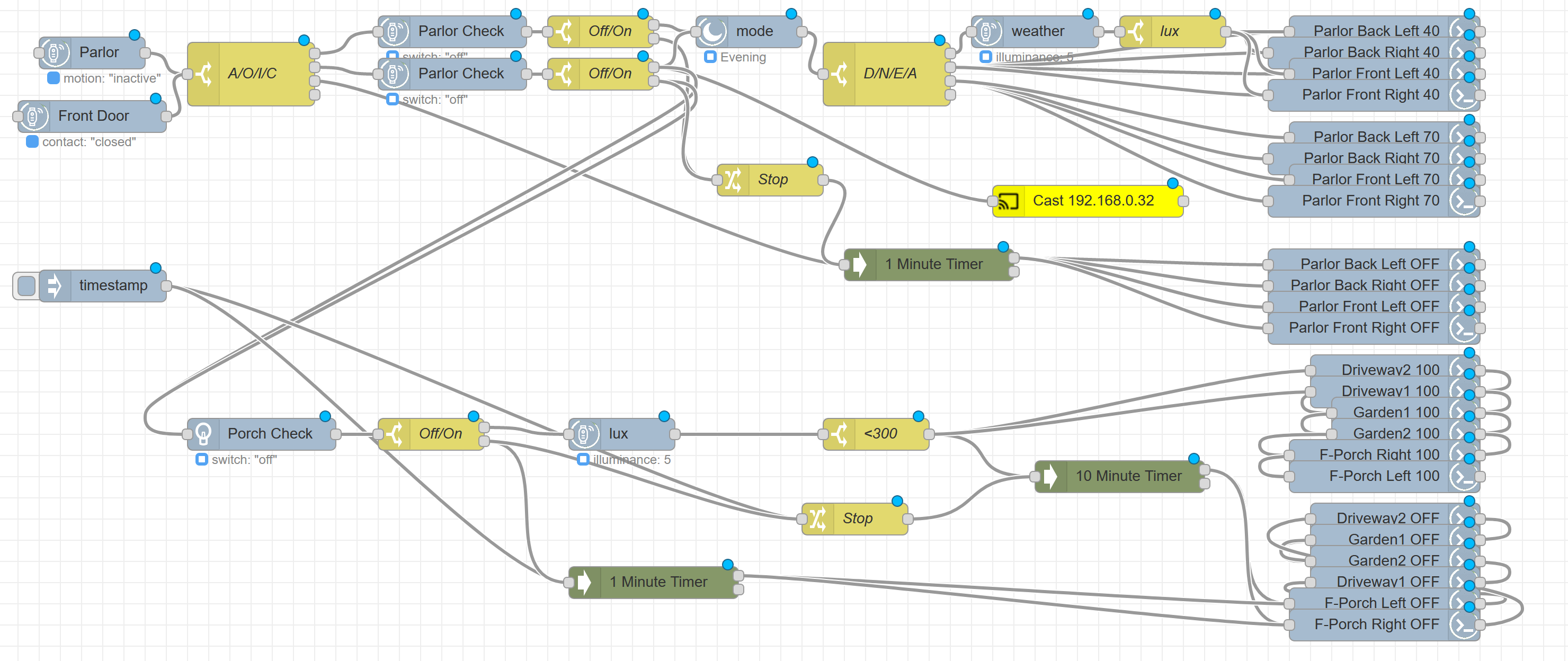

Here is one of my full flows that incorporates mode, lux, contact and motion sensors in a dance to control multiple lights both in a room inside and multiple locations outside of my house.
I'm sure this can be made much simpler but hey it works reliably and fast and thats all that really matters :slight_smile:
