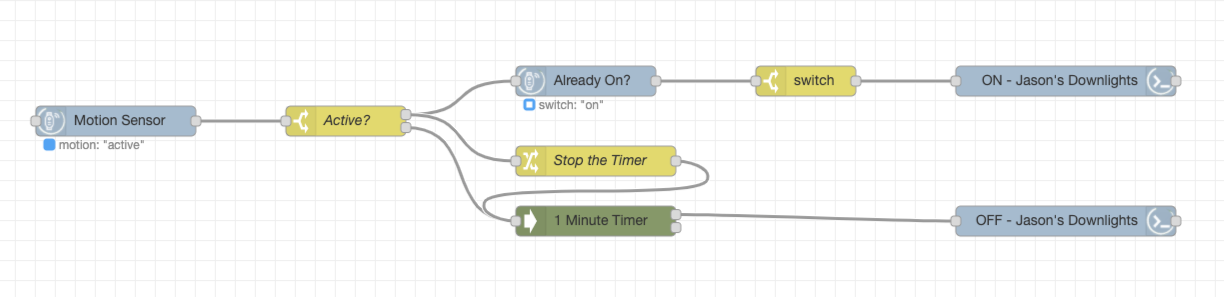

I fully understood the reason: The timer was started by an "active" event, but if I don't stop moving, my motion sensor never sends a subsequent "active" or "inactive" event to reset the timer. I had a fair idea of what I needed to do to fix it, but seeing this post made me see a solution, even if it's a little different from yours. In my case, I haven't done it through a Function node. I just did it with a Change node, setting msg.payload to "stop".
Here's my working sequence. I haven't added any conditions yet (eg. lux or mode), but this has been a good learning experience. This seems to work as I want it to for now.

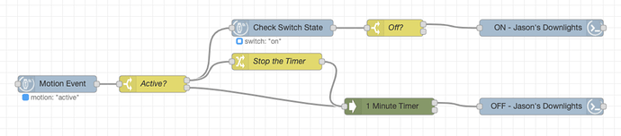

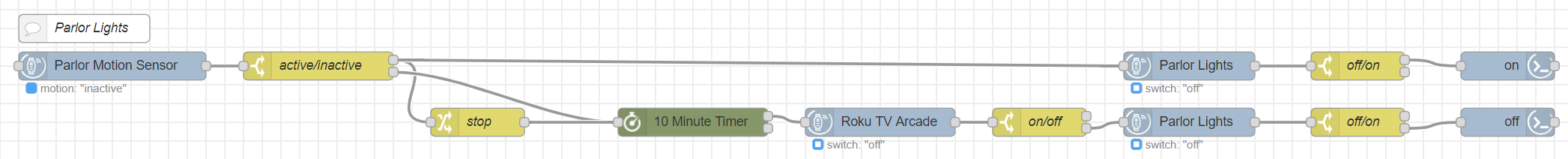

Here you go. It is more or less the same as yours above.
This one uses an Ecolink motion sensor. Those stay active continuously if motion does not end within the timeout (which is a super long 4 minutes by default).
The basic idea is that you don't start the OFF timer until it goes inactive. And you STOP the delayed off timer if motion becomes active again.
It checks the current status of the lights, and doesn't try to turn them on/off if already on/off. Could also be done with a change node to set the msg.command, an RBE node, and a single command node. I find two separate paths cleaner/easier to read though.
It also will not allow the lights to turn off if the TV is turned on. Just ignore the "Roku TV Arcade" and next "on/off" node for your case.
Cool. Looks like I ended up with pretty much the same design. I realized after posting, that a couple of my node names probable weren't the best/clearest, so I changed them and re-organized things a little. Here's how my sequence looks now:

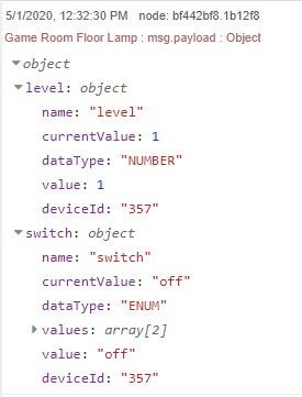

The drawback I found however is that an all attributes device node sends 2 different formats of information depending if it was triggered or if an event occurred with the device. When triggered it sends an object containing an object for each of the device’s attributes. This is an example for my 2 attribute Floor Lamp Bulb:

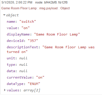

Whereas an event triggered output has a payload with an object with details of the attribute that changed. Here is an example of the switch in that bulb changing:

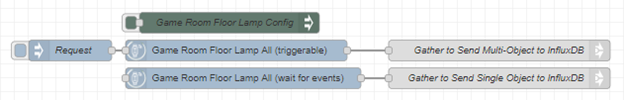

Thus, to get all of this information, I had to set one node to not send events and have it triggerable via injection and set one node to send events but not to have it triggered. As a result a sample flow looked a bit like this:
And since I wanted to put all of the information into my database, I had to build 2 separate processes to handle the 2 types of inputs. The one getting the multi-object input as shown in the first image had to parse out N-number of individual inputs

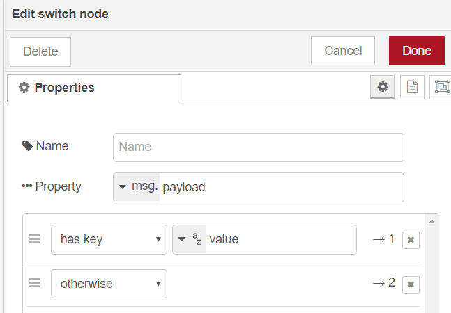

No matter what you would need 2 different parsers, but couldn't you have just run the single node that spits out triggered and event payloads into a switch node, and did a quick "has key" check on msg.payload.value to pick the path taken?
Not a big or real functional difference. Just asking.
I was replying when I saw your revision with the screenshot. You are correct I think your switch node solution works equally well.
