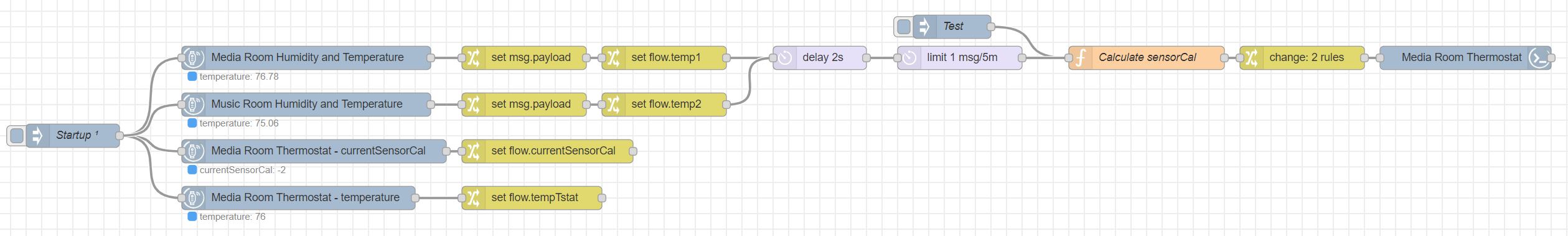

Do you mind sharing your thermostat flow? I'm happy with my Ecobee and using it's sensors for the Master Suite HVAC but I have a GoControl for rest of house and would like to use external temp sensors with that also.
Well, if you have a gocontrol gctbz48 you can just bias the thermostat reading to match another reference temperature (if you are using my enhanced driver - not available in the in-box or bcopeland driver versions).
Or if you have a thermostat you can't bias the temperature on, then you would just have to play games with the setpoint (raise/lower) to get the target temp to what you want using 'notch controller' techniques. Which is just a fancy way of saying on a fixed time basis (or fixed delta basis) check temp sensor vs thermostat temp and raise/lower SP by 1. Wait, repeat.

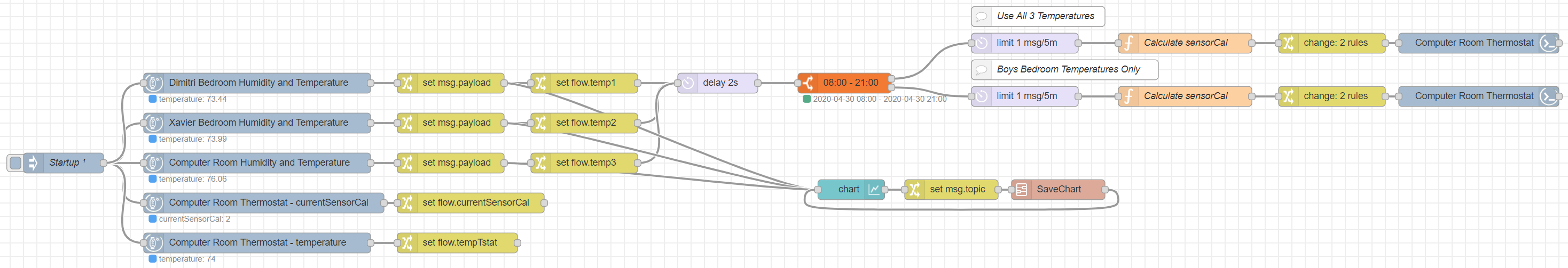

For example, in this flow I average 3 temps during the day, but only average the 2 bedroom temps at night. And apply that temp as a bias on the thermostat temp.

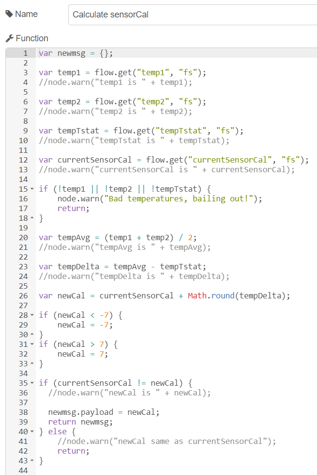

One of the rare times I use a function node, but it was really necessary for this calc:
Nope. Something much simpler. I set the thermostat temperature to 3 degrees lower (or higher for heat)) than the temperature registered at the thermostat, and then turn the thermostat off when it reaches the 1 degree lower (or higher) than the desired temperature (based on sensor avgs).
And this process kicks off again when the temperature is higher (or lower for heat) than the desired temperature by 1 degree F.
The house has remained comfortable with this approach (I shoot for 71-21 F). Rel. humidity remains around 55%. And the average heat-pump run times is 24 minutes .....

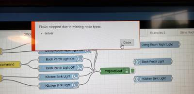

Is anyone else having this problem? Missing server? Nothing working at the moment and I have restarted my Hubs and Node Red? I don't know what I'm missing? Thanks
Only "server" node I have ever had on my system (that I can think of) was in the Home Assistant node set. Have you ever had that on there, or recently added/removed it?
