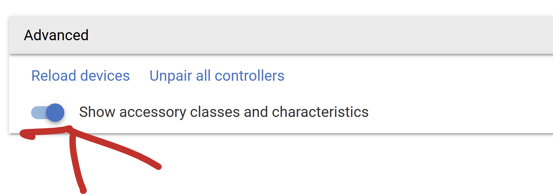

Anything that is a button/button controller. Uncheck this within the Homekit integration (beta). If you're unsure what's being reported at the bottom turn on "Show accessory classes and characteristics" and you will see what devices are reporting as...

At the bottom of the integration click Show characteristics and you can see what the device is being exported as. If button is there, export as switch instead
