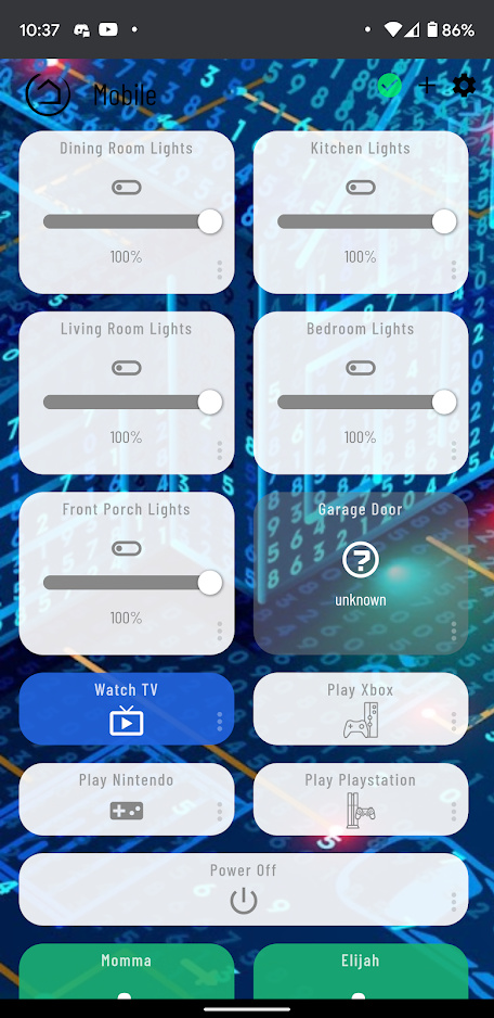

I'm a Hubitat newby. I got the MyQ Lite setup and had it running with an On and Off switch until I got my Smartthings sensors installed today. I've changed the drivers on the Garage Name (MJ's Garage). I've got the garage position tiles in my Dashboard.
What I'm trying to do is create buttons in my dashboard that will show the status AND open and close the garage doors. Can someone help me out with setting that up?

I THINK the driver you mentioned is the one I'm using, but I will check when I get home. My OLD configuration wasn't pulling status, I just created the two buttons, then used custom icons.
Like I said, I'll check the driver when I get home, but other than that I have the MyQ installed in the Garage and the tilt sensor that came with the product on the door. Are users adding additional tilt sensors to pull status then? Do you keep both of them so MyQ and HE can get status, or is there another sensor I need to get that works with both?

Yeah except if you buy a sensor you’ll stop using the nosensor version and switch to the one that uses a sensor. The nosensor doesn’t report state whereas sensor does
Thanks.... Not in possession of an extra sensor yet. And my current Garage Control button isn't working. Do I need to go back to the two button method until i do this?
