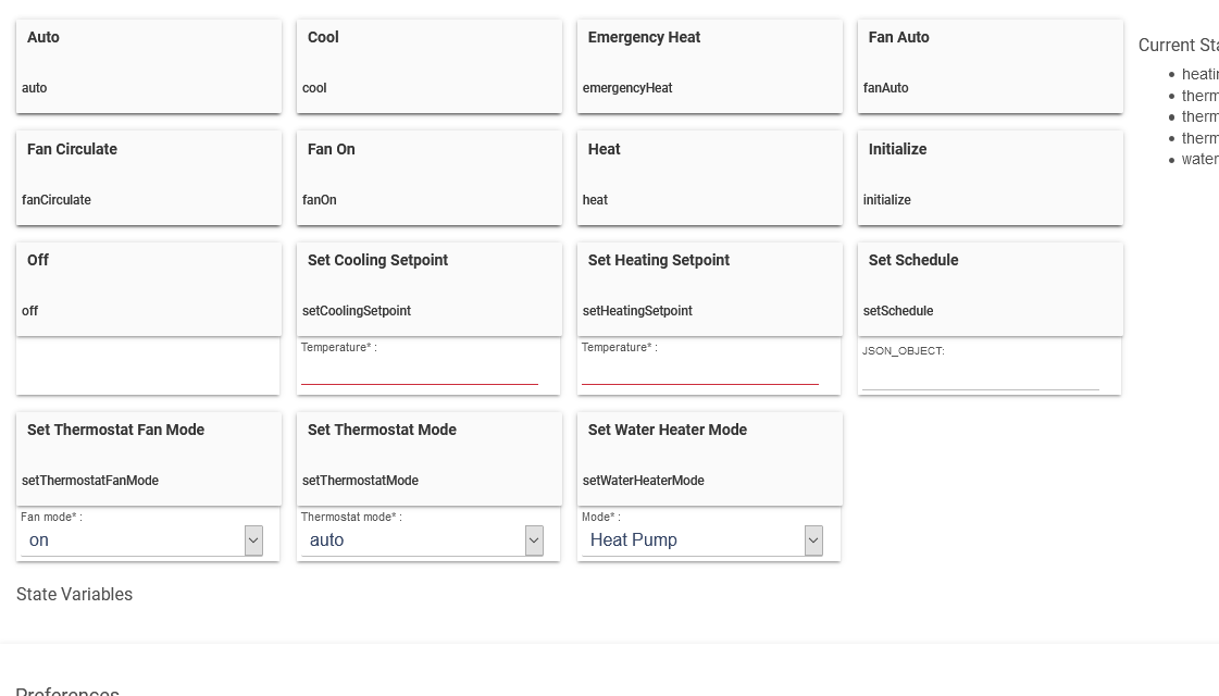

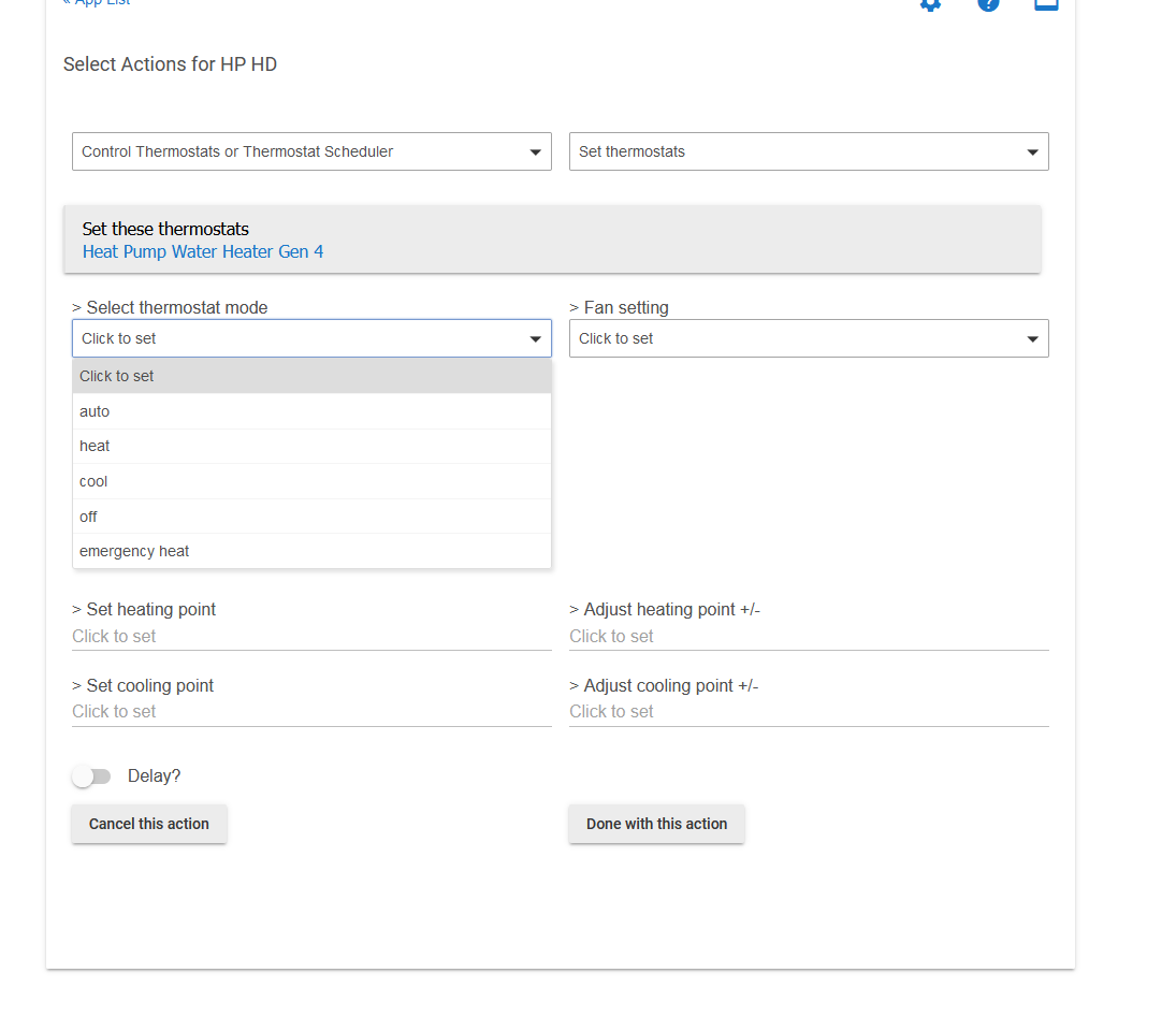

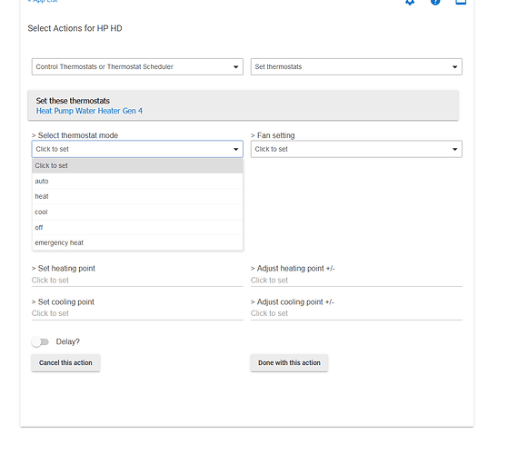

I am currently trying to setup a rule in rule machine to change the device from heatpump mode and high demand at certain times of the day. However i don;t seem to have Heat pump mode or high demand mode showing under rule machine>thermostats
I can see all the modes under devices,
I guess my question is how do i access "set water heater mode" in rule machine?
The way this works is it has to use the Thermostat properties in Hubitat. So there are equivalent names for all these heat pump names that might be found on an ordinary thermostat.
For example, (off the top of my head, so please double check me) Emergency Heat is the same as High Demand mode on the heat pump, so you would select Emergency Heat in the thermostat properties of Rule Machine if you want High Demand.
Again from memory,
  • Auto mode = Energy Saving (Eco?)
  • Heat = Heat Pump only
  • Emergency Heat = High Demand
Anyway, use the equivalent thermostat mode, and it works. It is confusing though to have a different name in Hubitat than what the actual Rheem name is.

Were you able to figure out how to trigger vacation mode?
I actually completely forgot. I’ll see if I can figure it out this weekend.
