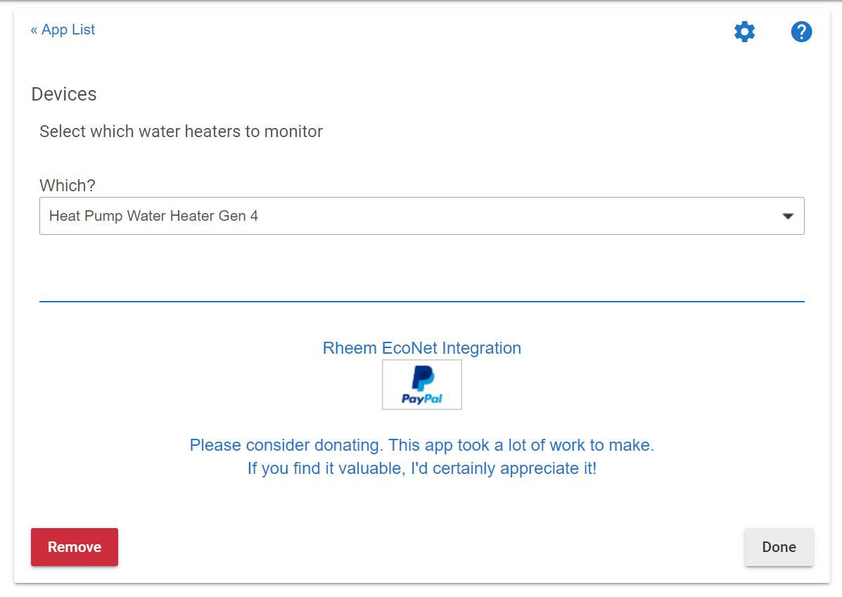

Sorry, I'll give a little more of a step by step. Open up the Logs page. While that page is open, go to Apps -> Rheem EcoNet Integration and page through to step 2 where you will see a screen like this:

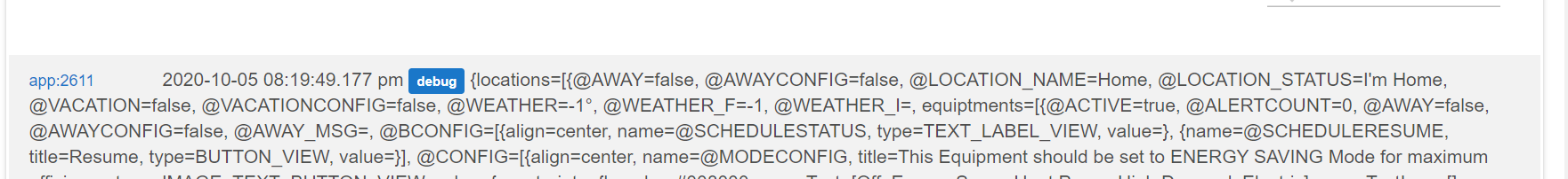

At that point you'll see a log entry like this:
That's what I need. Basically I need to see how to detect the particular capabilities of your device.

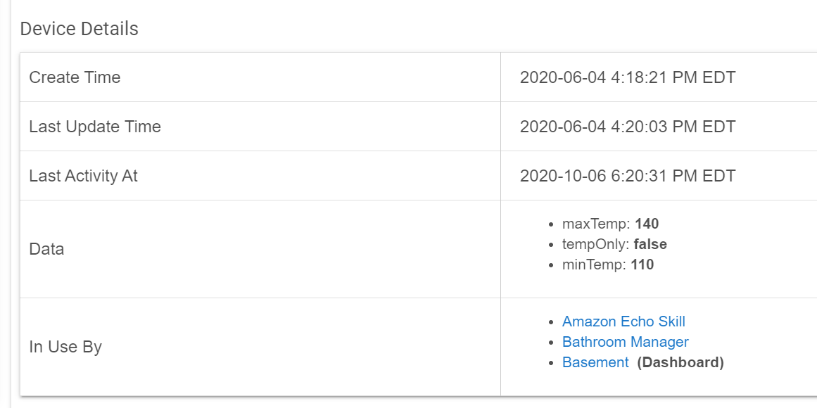

At that point, go through the app and let it create your device. At that point, go to the device for your water heater and scroll all the way to the bottom and you will see:
By that tempOnly you should see another entry that says enabledDisabled true (I hope). If it doesn't, let me know because I screwed something up. If it does show up, then give the modes a try. Basically the way I designed it is you have two modes, off and heat (basically disabled and enabled).

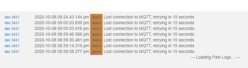

For some reason I suddenly got these errors after working great for months now. I was able to log back in and it stopped the error. Not sure what is up with those all the sudden? Maybe Rheem "cleaning house" or something?
Also, PM sent.
I think they had a brief outage. Had the same logs at the same time but mine reconnected on its own around 9:30
Once in a "blue moon" you have to hit the "Initialize" button on the device page. That resyncs the MQTT and things move right along again.
