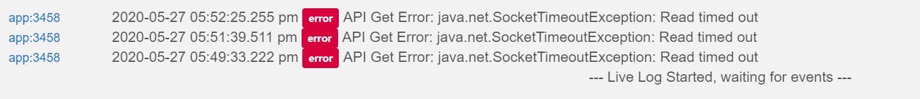

Let me delete the device I created and test again. It I. The last message I showed you the errors that the app had when I tried it and got the no water heater found message. I will test again.
OK, Deleted the device I created manually, and then tried to rerun the initial add of the app. I entered my User ID and password for EcoNet, and got the same error, No Water Heaters Were Found. The error below is the same one I had before.
