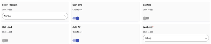

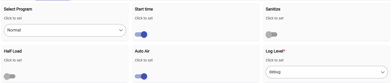

The other feature I'd like to confirm is how to set a cycle to start at a specific time using the Set Time preference...I want to accomplish my "Button Dream" of being able to tell my wife "Just put in the soap pod, close the dishwasher, and press that button and it will start at 9:01pm." :slight_smile:
Related to that, are the options in Preferences all now fully supported? As noted the "Start Time" option is particularly interesting to me. Implies that setting a delayed start for a specific time is currently supported, but not sure if that's just left over/non-funct stuff in the driver. So are the Preferneces all working at this point, and how/where can I set the Start Time if it is enabled?

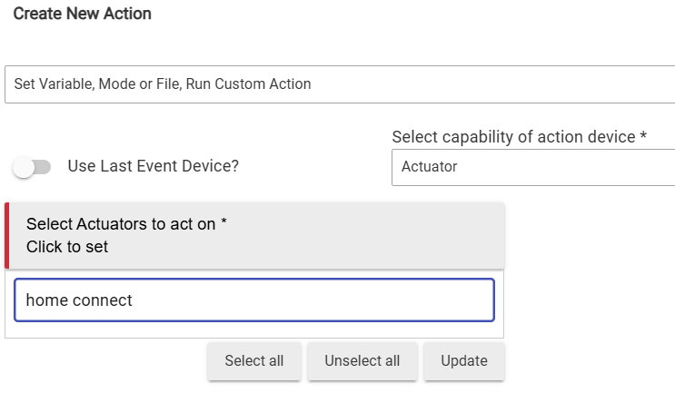

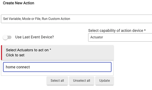

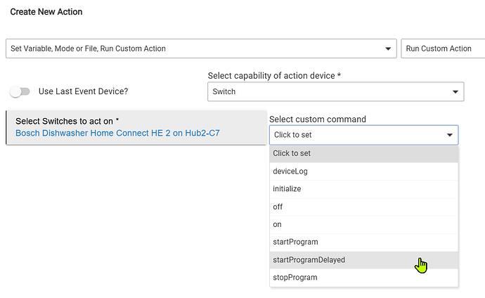

I looked in Rule Machine and there isn't a "Start Time" actuator (if I choose Actuator as the option in RM the dishwasher doesn't appear in the list of available devices).

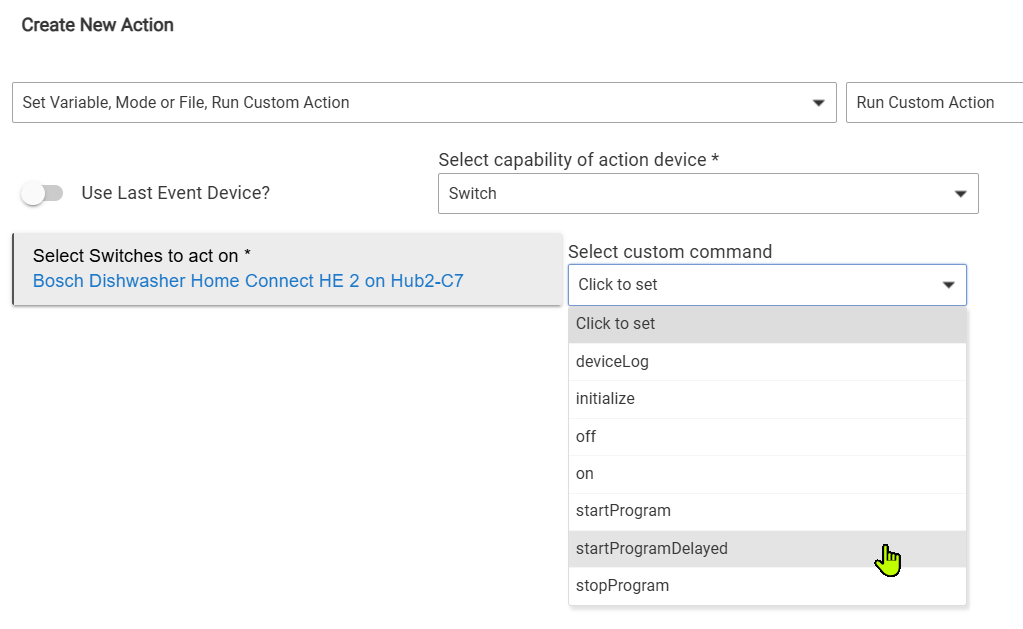

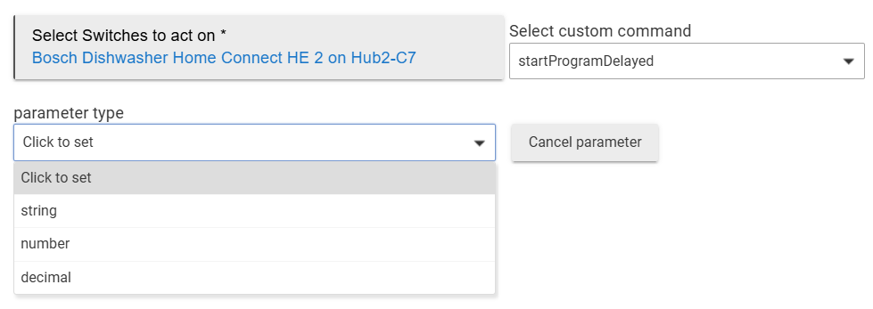

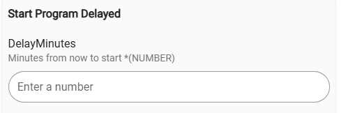

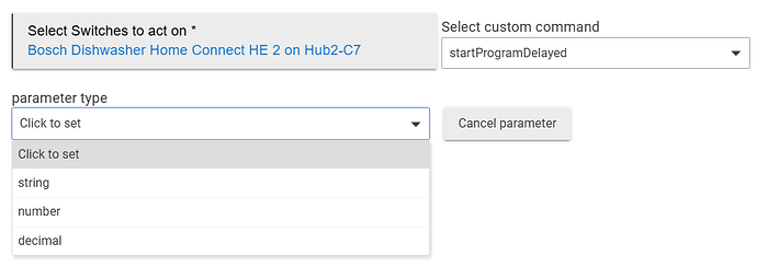

If I choose Switch as the custom action type there is a startProgramDelayed option, but that only seems to allow delaying by some set amount of time, you can't set a time of day for the cycle to start.

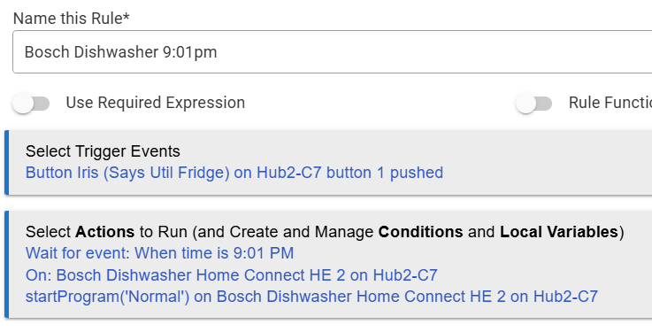

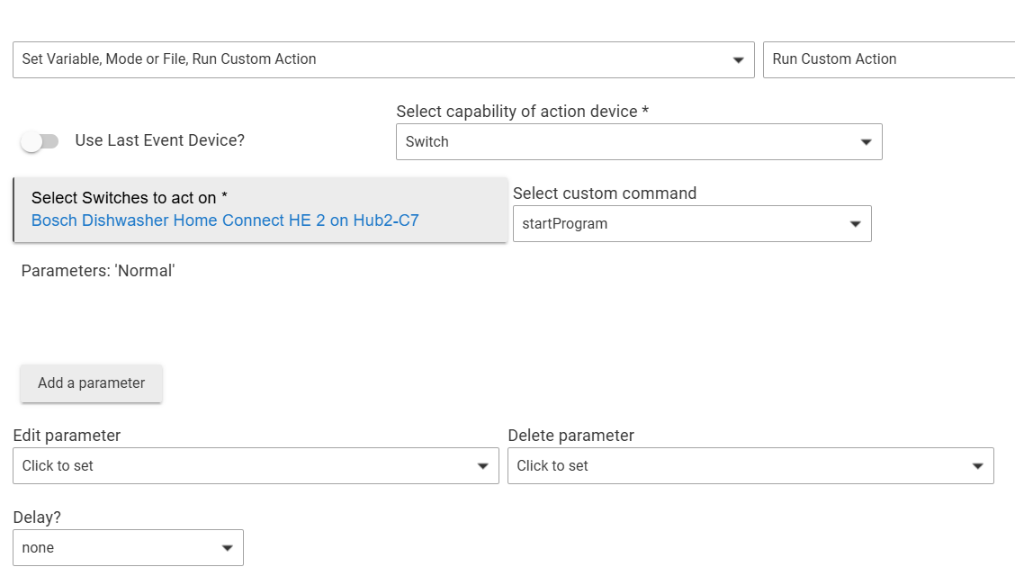

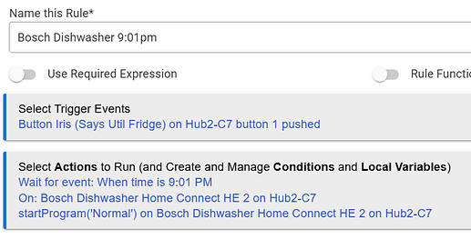

There are simple work-arounds, like setting startProgram to initiate the "Normal" cycle:
...and then adding a "Wait > Certain Time" delay in the rule as below, but since the "Start Time" option is listed on Preferences thought I would ask if it is (or will be) available in RM and Button Controller as an Actuator/Custom Action... :slight_smile:
