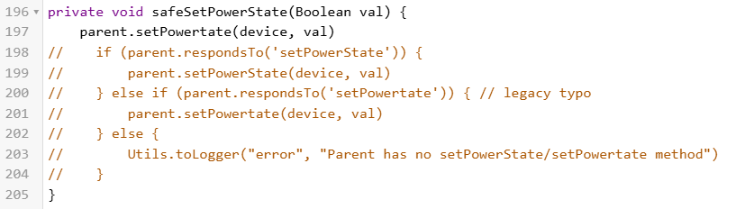

My Bosch dishwasher automations started failing in October. I've just rolled up my sleeves tonight and saw that you had mentioned that the "On" wasn't working and causing errors. The error is in the "Home Connect Dishwasher" drivers code in the safeSetPowerState section. I've modified the section to the below code and it's working again for me. It also fixed the "Off" button as well. I hope this helps someone.
private void safeSetPowerState(Boolean val) {
parent.setPowertate(device, val)
//if (parent.respondsTo('setPowerState')) {
// parent.setPowerState(device, val)
//} else if (parent.respondsTo('setPowertate')) { // legacy typo
// parent.setPowertate(device, val)
//} else {
// Utils.toLogger("error", "Parent has no setPowerState/setPowertate method "+device+" "+val)

Thanks! I put this in my code and gave it a whirl, and worked, both On and Off buttons function as expected! Magical update. :wink:
I did notice that the code has both and "setPowerState and setPowertate in it. It looks like an "intentional typo" to deal w/errors in other locations of the Home Connect Integration app/drivers code, or ?

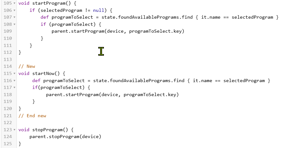

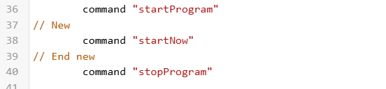

Also just remembered that you also posted code to add the StartNow button! :slight_smile:

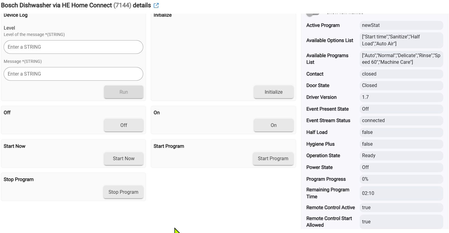

I added that code and have the Start Now button, but my Start Program button doesn't have a drop-down like yours does...

Did I miss something (likely obvious :wink: ) I did run an Initialize and that didn't add the Start Program selection box. Maybe some change related to available programs? I do have that field populated in the driver... :man_shrugging:

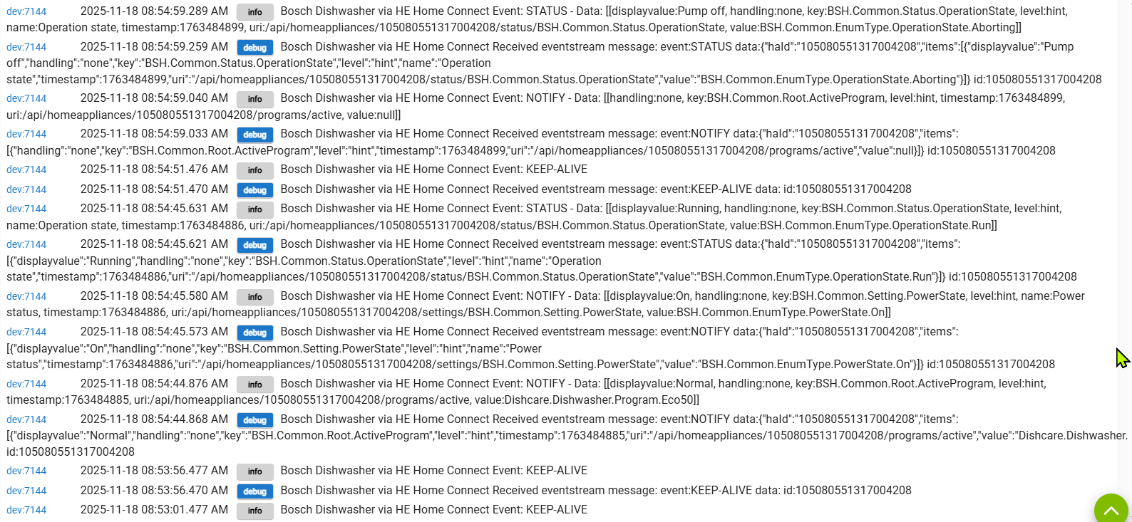

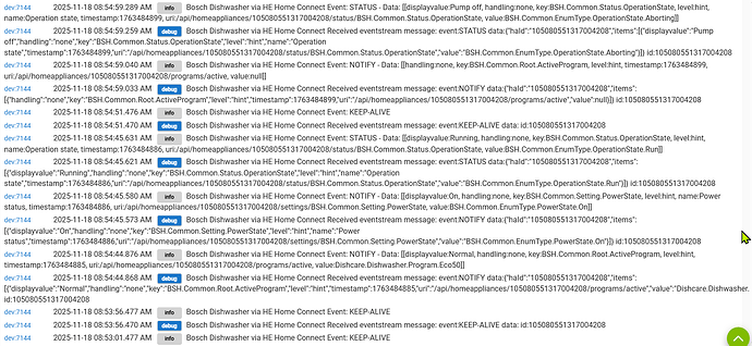

Secondarily (and sorry for carpet-bombing you with questions, I know you don't maintain this integration...so you are of course welcome to say "Sorry, can't help you with that.") The Start Program button does start the washer. However hitting the Stop Program button doesn't stop it. Is that expected and I need to send a parameter w/the Stop command via a rule, or ?

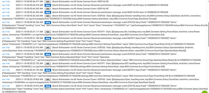

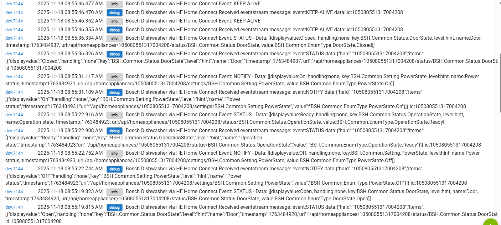

Logs from when I issued the "Start Program" command from the Device page:
The "Select Program" drop down list isn't under the "Commands". It is under "Preferences". The "Stop Program" worked for me last night, but that doesn't mean that it's 100% good.

I tried the start/stop a second time and both worked, so maybe a momentary glitch. :man_shrugging:

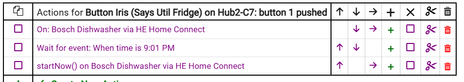

I'd like to set up a button in HE to turn on the washer and set it to a 9pm start (reduced electricity costs later in the evening). I can do this using a simple "Wait/Certain Time" in a button rule and then a "Start Now" custom command.

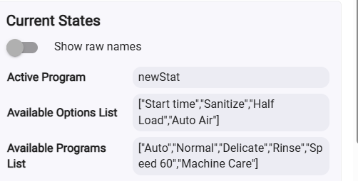

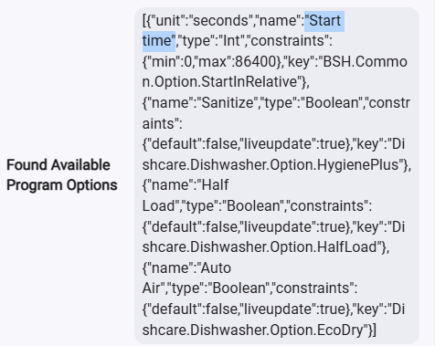

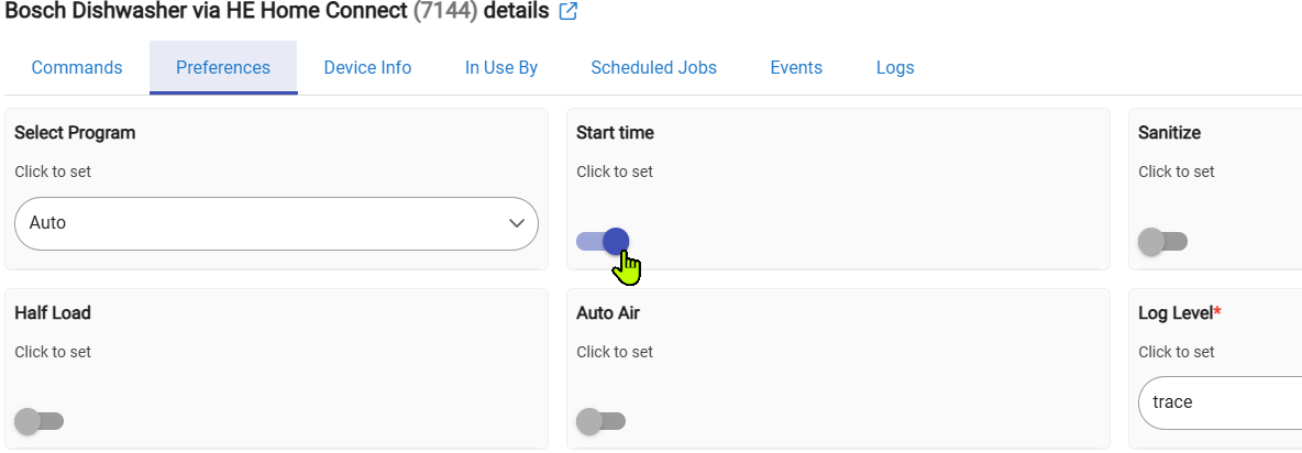

However, I do see an option in Preferences to set start time, but enabling it doesn't seem to have any effect (either in the Driver UI or in Custom Command options in Rules). In fact I can't find a single mention of "Start Time" or "startTime" or anything similar in the Home Connect integration app or the Dishwasher driver code, so not sure how that even appears in the Driver UI. The Start Time options are shown in the "Available Options List" and "Found Available Program Options" whether or not the Start Time toggle is enabled in Preferences.

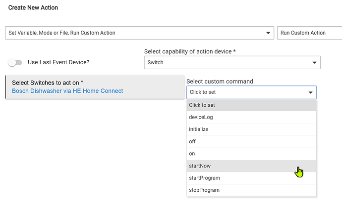

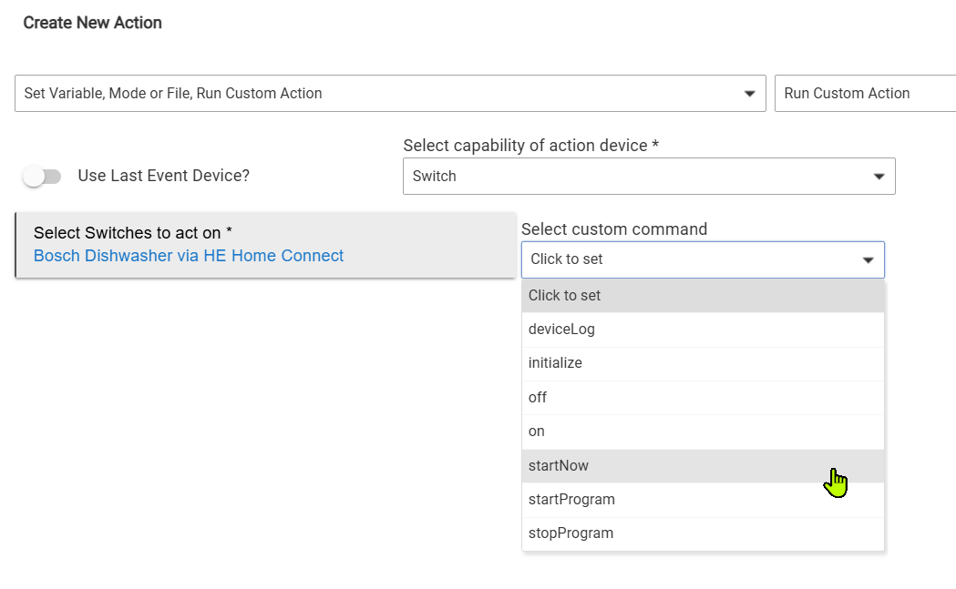

I don't see any Start Time option via Custom Command...

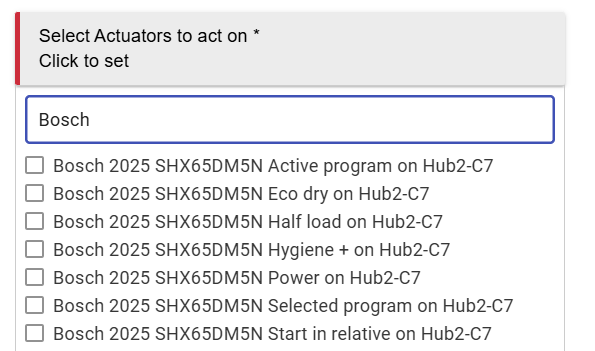

And there are no options under Actuator for the Home Connect integration Dishwasher (the ones listed below are all from the Home Assistant dishwasher integration that I'm also playing with):
Can anyone provide some info on using the "Start Time" option directly to control dishwasher starts in Rules?
A quick look seems to show it is not actually implemented. It would need a few lines of code in the app and the driver to enable it.
If you update the app and the dishwasher driver with the new versions of those files from GitHub - craigde/hubitat-homeconnect I think it will work

BTW, I was looking at your code a day or two ago and I think the bits to provide the "Start Now" button in the driver are not yet included in your version of the Dishwasher driver...post on that w/the necessary code here..

On the StartNow thing I had just updated the existing StartProgam function so that if you did not specify a mode it would fallback to the last mode used. If there was no lastmode state and no mode provided it will default to normal.
