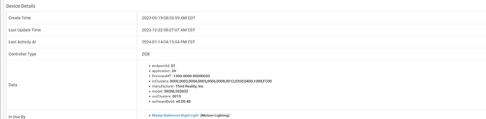

I don't see a way to update firmware, in case that's the problem.

Mine came with newer firmware. You're on .48. I'm on .50. I'm guessing that this is the issue. Is third reality on here to tag? @ThirdReality . Ah. looks like they are. Help us Obi Wan Kenobi. You're our only hope. I think you broke this in the .50 firmware.
