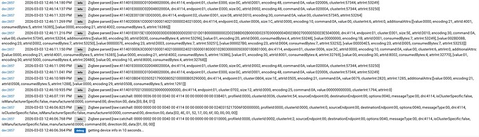

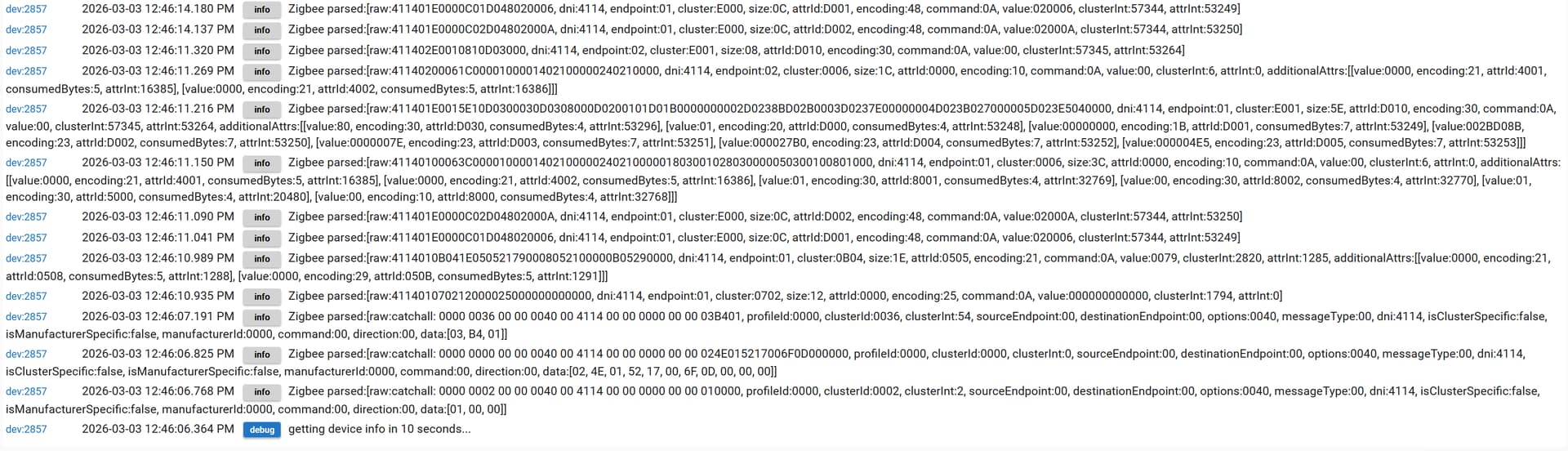

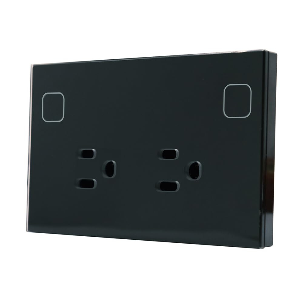

New zigbee dual recpticle fingerprint
@mike.maxwell This uses the generic zigbee outlet driver. Both outlets are zigbee but both turn on/off with a single command. They aren't seperate with the generic driver. Not sure if each can be controlled separately (though each has it's own touch control and it shows seperate in the tuya app)
Manufacturer Louysgen
They say it's a Tuya smartlife on amazon
Here is the link (They come in black or white)
How-To-:-Identify-a-Zigbee-Device

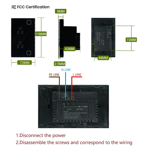

How's the construction quality of the outlet? Any UL certification?
It's chinese so no UL only Ce. Construction seems really solid. You can see everything under the glass cover (which you need to remove to mount)

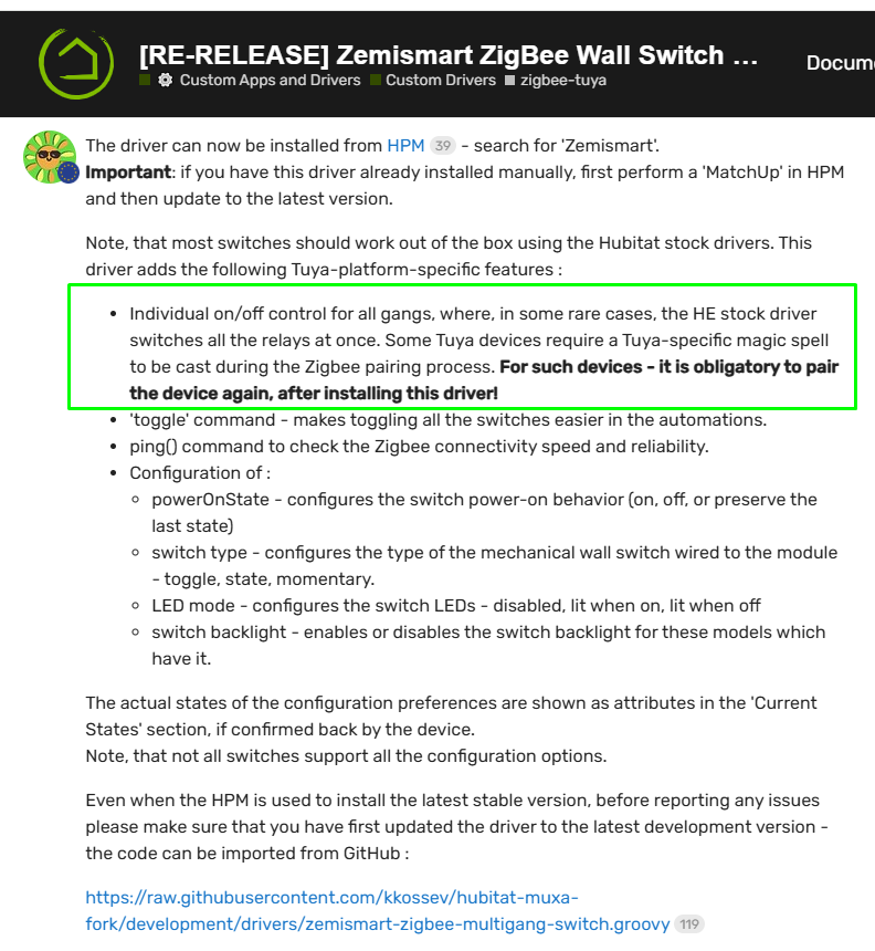

If you want to use a built-in driver, use "Zigbee multi-endpoint switch". The outlets will be controlled independently.
I went with the zemi. Works great and handles the LED's on the unit.
