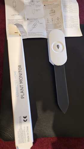

I ordered from the link in the first post (Aliexpress) but received device is somehow different. White plastic. I'll send a photo when I can.

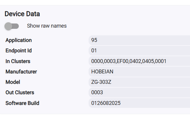

device data shows:
I don't know if this is supported or not.
But if it is supported, which device model should I choose from the list in prefs ?

here is a photo of the device.
maybe it is a good one, not the one you were complaining about.
but will it work with Hubitat ?
This device includes standard ZCL clusters for temperature and humidity in its inClusters list. So, it may be compatible with some of the HE built-in Zigbee drivers for humidity and temperature. It's advisable to start by trying out some of these built-in drivers.
