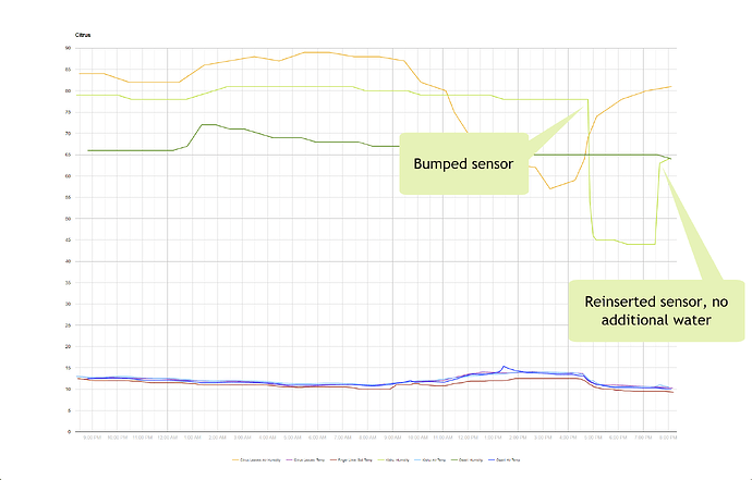

Thought I'd update regarding my previous comment on this blue silicon wrapped sensor's sensitivity to being disturbed (and these capacitive sensors in general).
I was moving my container around, tilting it while lifting several times and while the sensor did not dislodge from the pot, I definitely saw a drastic change (drop) in the humidity readings.
Simply reinserting the sensor returns some of the humidity but from my experience, the most accurate/consistent results when performing any repositioning of the sensor require it to be watered in again:
If you water after, it will follow the pocket of humidity in the soil as expected as shown in the graphs in the previous posts.
If its a larger pot, you don't need to water the whole pot nor do you need a ton of water - just enough water around the base of the sensor so that the soil reforms and interacts tightly with the blade of the sensor:
Best to set it, water it and don't touch it.
