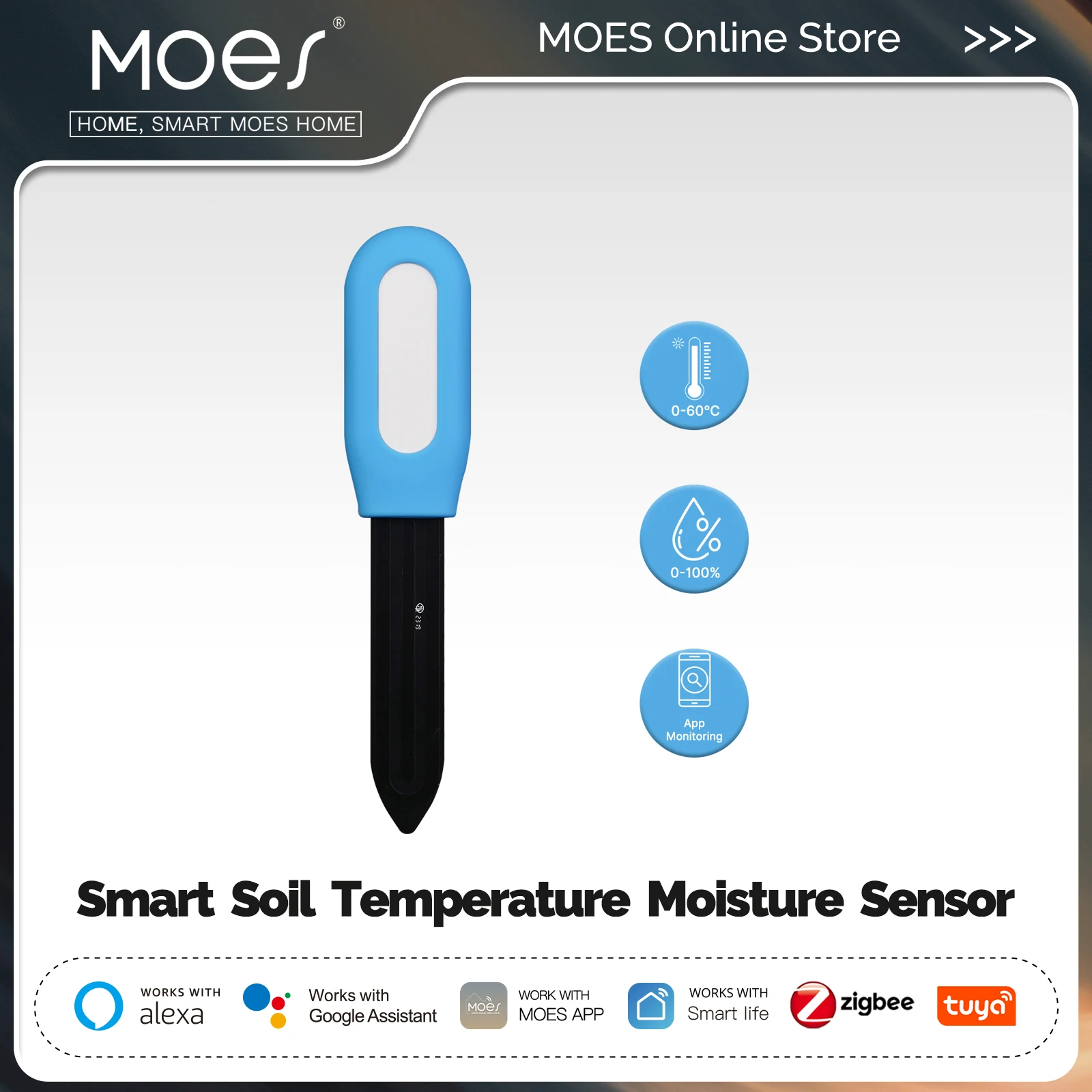

[NEW] Tuya Zigbee Soil Tester
There is a new Tuya Zigbee Soil Tester (temperature and humidity sensor) available on AliExpress :
AliExpress .us : (link)
AliExpress .com : (link)
Note: that this is the only one Zigbee model that I was able to find at the moment!
There are many other sensors that look similar, but they are have BT interface and can not be paired directly to Hubitat hubs.
If in doubt, ask the seller for a confirmation that what you order is really a Zigbee device.
Unlike the previous models (with the three metal probes), this one works very well!
EDIT: the soil moisture measurements are suspicious, need more time and more data gathered.
It is now supported in Hubitat - Tuya T/H custom driver. Make sure the driver is updated before you pair this device.

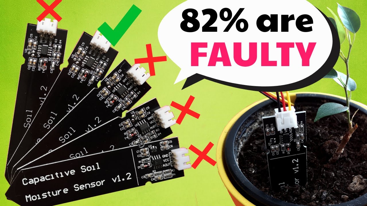

I'm following out of hope that one of these low price units will finally be worth the effort but even the ones based on capacitance (like this one) are proving to be unreliable.
There are a handful of youtubers that have run pretty fair testing confirming why the instruments that do this job well for Science & Ag cost many times more than what these coming out of the Ali-mills.
That said, if one came around that was actually fully waterproof, had good radio reach, battery life, and was reasonably accurate at indicting "moist vs dry" at ~5" inches down...I'd be satisfied.

I am going to crack open one of my 2 sensors in the next few days and check whether what I have received is not among the 82% of faulty sensors on the market... The symptoms are very similar to what is described in detail in this video 2 years ago.
82% - that is a very precise figure! Was it obtained using a calculator purchased on Ali though?
Yes - based on many sensorsโ€ฆ. And the calculator is 99% from AE tooโ€ฆ :rofl:
Nowadays almost all of this stuff at this price comes from Ali ( AliExpress for the end customers, AliBaba for B2B ) :slight_smile:
Forgot Amazon - a lot of gadgets also coming from Ali drop-shipping sellersโ€ฆ
yup, I think that's one of the videos I watched.
