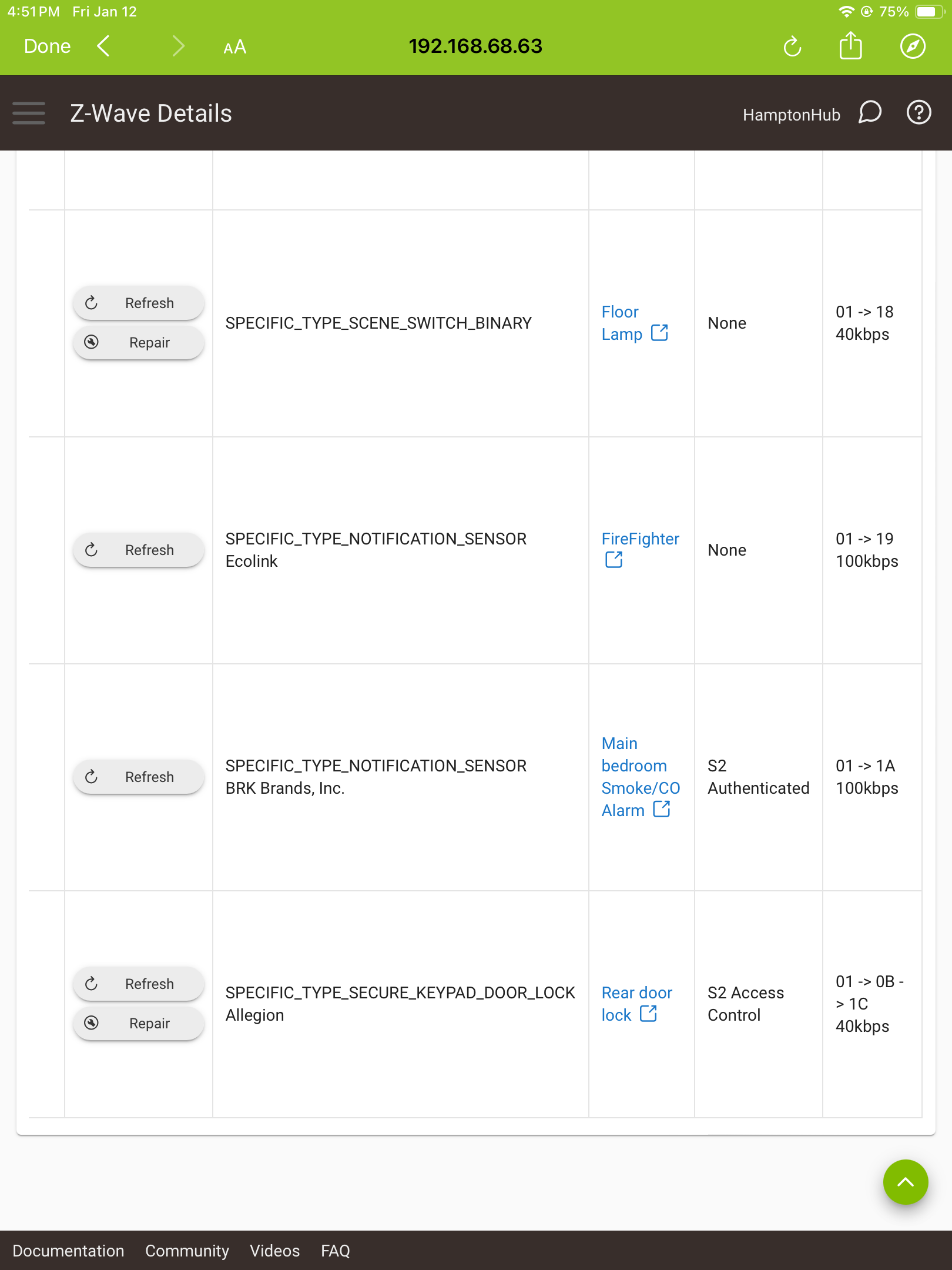

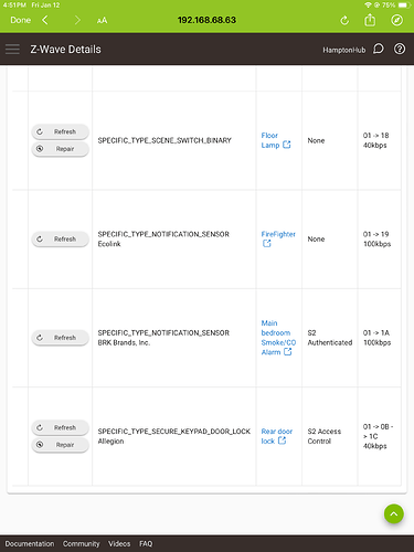

The new lock shows “S2 Access Control”, not “S2 Authenticated” like my other S2 devices. I don’t know if this contributed to my difficulties or just a sign that something is different in the firmware perhaps. See screenshot.
1st can you post your z-wave details page in it's entirety? (use windows snip)
2nd. You need to pair the lock within 2 feet of the hub because of the whisper mode encryption key exchange the lock does on pairing.
Mine paired while in the door 25 feet from the hub.
Each environment is different...if pairing from a distance doesn't work, then getting very close is a next step. ![]()
@user2693 - It would be a very good idea to take a look at your Z-Wave Details page as @rlithgow1 suggests, both to confirm you aren't creating ghosts the failed attempts, and that there aren't other pre-existing ghosts that might be causing problems w/pairing.

This is normal, they put themselves into that group to avoid being in the same group with regular devices. Access Control is an elevated group typically for border/entry devices.
