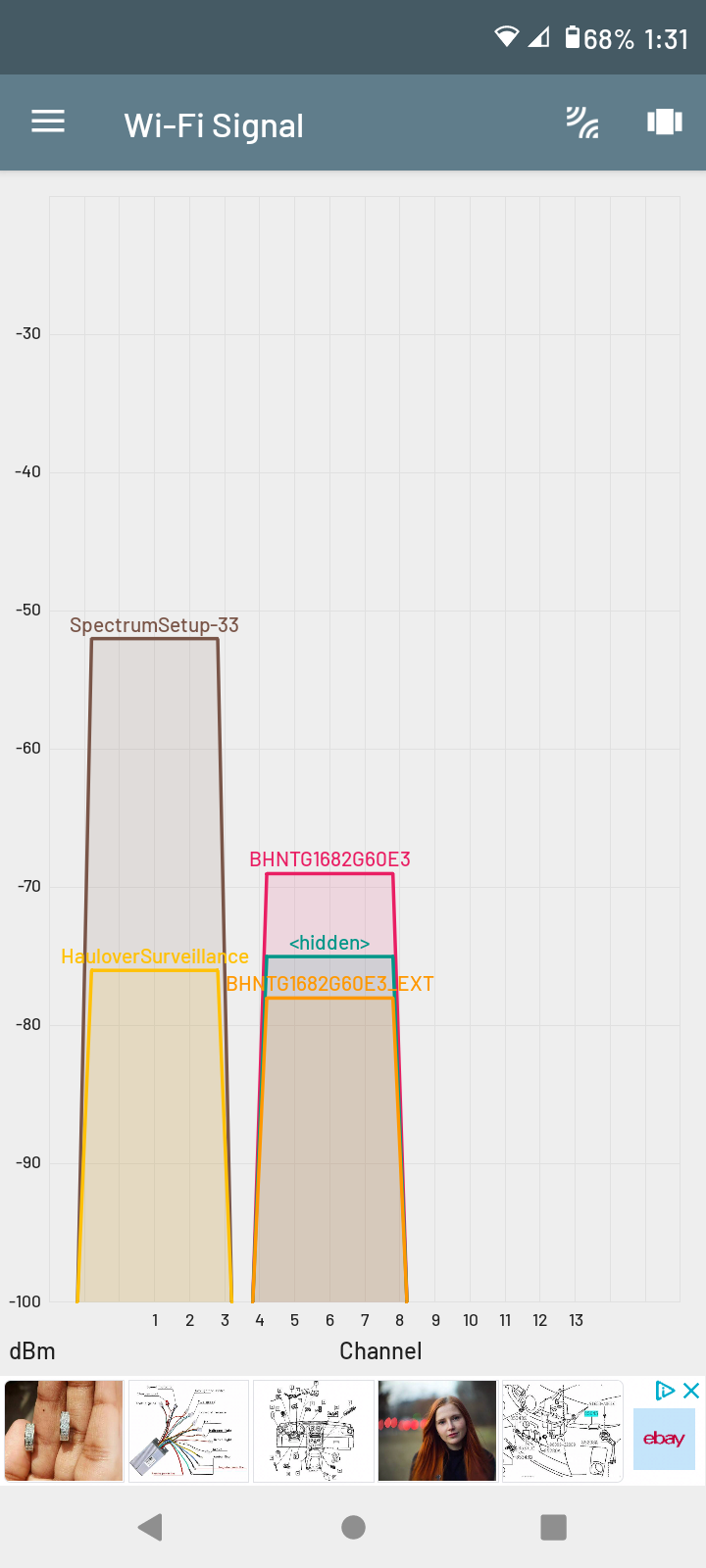

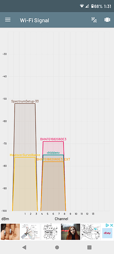

Also, if you have any android devices grab a Wifi analyzer app and you can scan to see what channel your Wifi is on, along with close neighbors, if the router interface is not telling you.
There might be a way to see it from PC also, but I have an old Android tablet handy I use.
WiFi looks good
Yesterday it was around channel 157
So yours is SpectrumSetup-33? Channel 1.
The 157 you saw another day is the 5Ghz spectrum, not related.
According to your other post Zigbee is on channel 20 which should be mostly clear overall and getting no interference from your router on Channel 1
The router is probably on auto mode, so it might change, but even if it picks 6 or 11 it still should not cause too much trouble.
