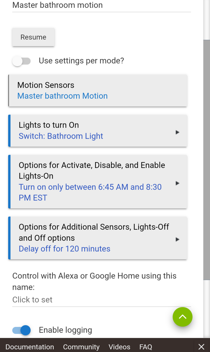

When I set a rule in HE ... Nothing.

Starts to sound like an issue with the rule, not the connectivity…
Yeah agreed except for the lack of events part. Even if it's a rule issue there should be events showing up. @junk7001 how is the motion sensor exposed to alexa? Via the Amazon Echo integration app on HE?
I want the motion active when you walk in. Stay on for approx 120min . Turn off the switch on the way out.
I would like it to stay on (without 120 mins) if the switch is manually turned on.

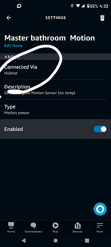

The motion sensor is added to HE. Added to Alexa skill

Open the hubitat device page for the motion sensor. Let it time out so it says "inactive". Then cause motion to activate it. It should change to "active" on the device page.
If that is not changing then there is no way possible for Alexa to know it changed either, unless the device is paired directly to a Zigbee capable Echo device.
