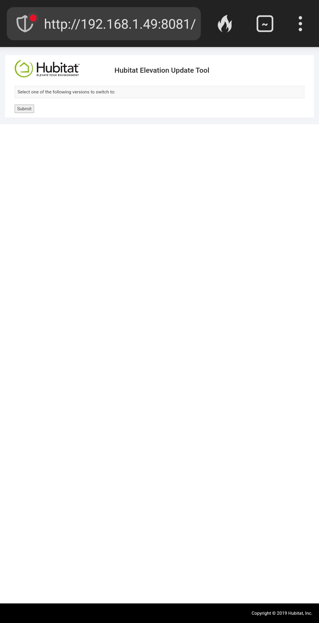

Diag screen asks to select update version, but none shown.

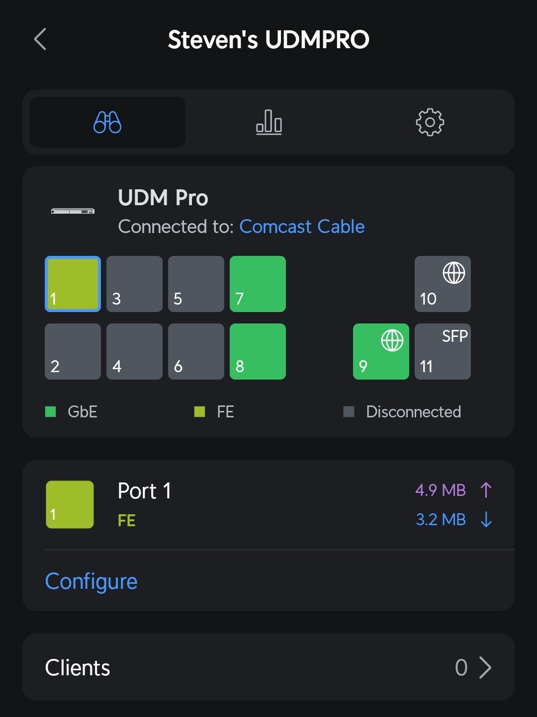

Router shows increasing upstream data, but downstream data keeps sitting at 3.1mb after multiple power cycles and resets.

Hubitat have updated their cloud a couple years back and I've read one similar message that meant the Hub is calling home to a home that no longer exists.
I wish my memory was able to dredge up more precise info, but my advice is to a) wait for someone else here to confirm or deny my memory, or b) submit a support ticket. Most likely here's the place for quicker answers.
Not sure if this is the same issue you're having, but seems similar. :thinking:
Alternate Hubitat User Portal for old Hubs
Edit: Pulled hyperlink out from linked post for easy access.
Nice find.
@plugers specifically in that thread this is what got it working for that person:
Thank you so much. It literally updated, and is working, in 1 or 2 minutes.
