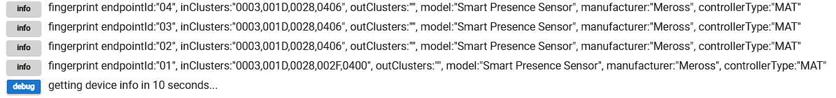

This is the pairing log from Hubitat...

If it paired to Hubitat, there is a TBR on the network; otherwise, it would never get that far. The issue here is one with the driver, namely, that motion/occupancy seems to be reported on three endpoints (from the fingerprint, I can't tell which means what, but the product descriptions mentions combination mmWave and PIR, so I'm guessing that's two of them), and the driver is probably looking at the wrong one.

If you are trying to use the community 'Matter Advanced Bridge' suite, then the correct 'device type' is 'Matter Advanced Bridge'. After changing it, refresh the MS605 web page in HE, you should see a button 'DIscover All'. This will start the Matter device endpoints discovery procedure, and the driver will then create child devices, depending on what this Matter device exposes. The MAB suite should automatically assign the correct drivers for each child device. I suppose you will see 3 motion sensors and probably an illuminance sensor.
