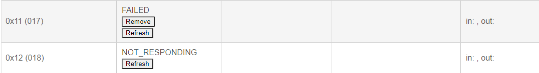

Seeing some unknown nodes on my C7. Are these ghost nodes? They don't show up under devices list. I suppose they are remnants of inclusion issues I was having with LZW30 switches. What would happen if I hit remove on them? Will they become even more of a ghost node O_O
I ran multiple zwave repairs but they aren't going away
@mraz.camren Yes they both seem to be ghost nodes. Go ahead and try removing the one with remove option. I was not able to remove those ghost nodes and ended up doing a factory reset from http://hupipaddress:8081

Will the remove option remove them from the Zwave network? Or they still linger with the Hubitat's database in a hidden state?

Its probably a device that didn't finish initializing. The hard part may be finding out what device it is.
You can try reboot first and click on discover and see if they update. I've fixed a few this way.
Otherwise, look at the device above and below and it may give you an idea as to when it was added to help you narrow it down.
Once found, try doing an exclude on the device and hopefully it should clear it up and you can add it back. (May need a few reboots too when doing this).
