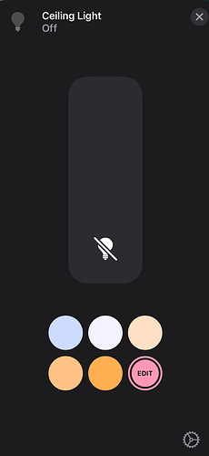

Has anyone been able to solve this? I am having an issue with an Inovelli dimmer having color capabilities in iOS (which it does not). This is on iOS 14.

I’ve added the picture of the colour selector from iOS that I want to eliminate.

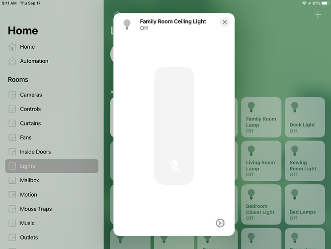

My tablet is iOS14 but the gateway device (Apple TV 4K) is iOS 13.7 still and Homebridge is running on rPI and it still looks right on mine.

I doubt you can remove attributes or capabilities from an already-existing HomeKit accessory.
I'm pretty sure you'll have to remove the accessory from the Maker API app in the HE, wait for the Homebridge plugin to detect the change (the accessory will disappear within 5 minutes of the change), and then add it back.
Andrew
One can. HomeBridge has to be restarted. However, the device doesn’t have to be removed from MakerAPI and added back ....
I beleive it’s a Homebridge issue looking at the Hubitat capabilities, I would try removing it from the makrAPI and Home app then add it back.
Just uncheck the device once in MakerAPI and wait until it is removed from the Home app. Then recheck it in MakerAPI and see if it corrects the issue. Removing it should remove all references to any of the published capabilities

Bizarrely, this worked! I wonder at what point Homebridge decided the device had colour capabilities. If it crops up again, I will let this thread know.
