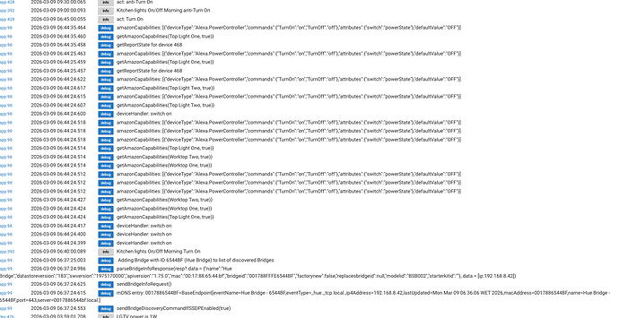

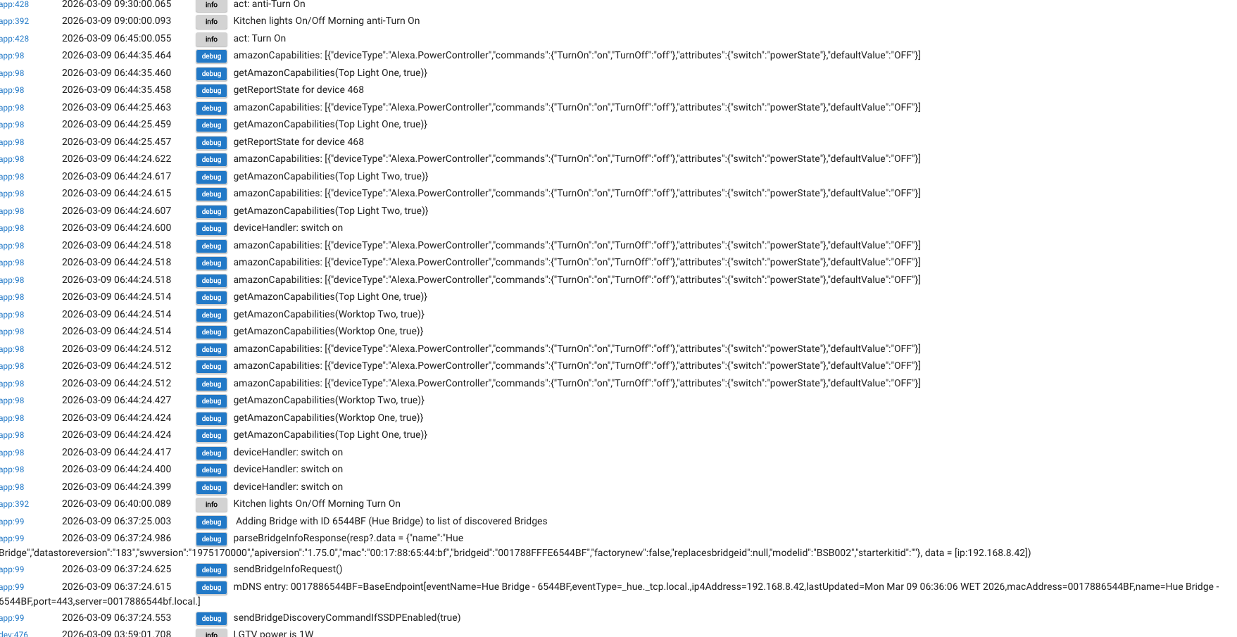

There is much that I don't understand here but this is a screen shot from Logs around the period when kitchen lights etc were due to switch on. Is this what you were asking for?

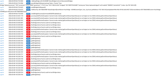

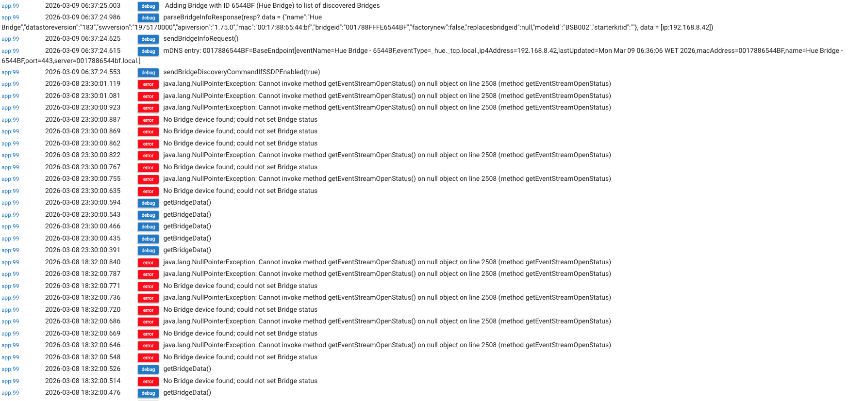

The errors on the Hue Integration App start much earlier, but here are the entries from today:

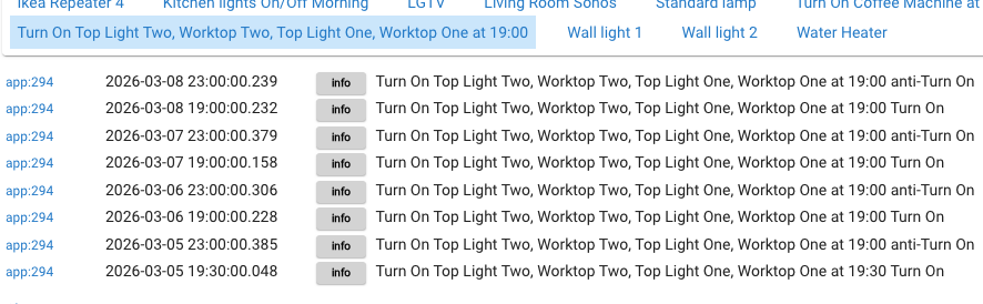

These are the logs for Simple Automation Kitchen lights i.e no entries for today:
Well it worked for one day and then, this morning nothing switched on and I have had to reboot. The logs show an assortment of "debug" entries, non associated with Hue and mostly associated with Amazon.

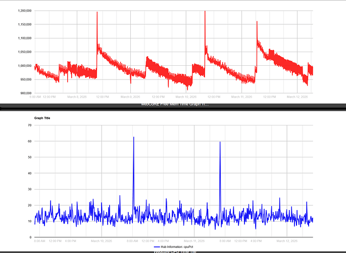

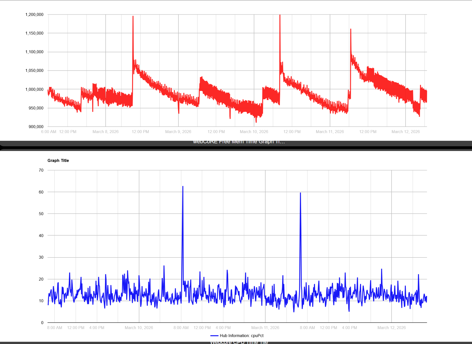

in addition to @Johnnyvaneddie 's comment. I would also install @thebearmay hub info app and Webcore graph and monitor memory dropoff. Also maybe set a rule that if memory drops below 100k then reboot

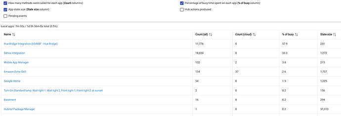

Hi Johnny, Same failure overnight and I can get App stats before I reboot. What are the most informative tick options that I should select?
Here is part screenshot as example and wonder if this helps:

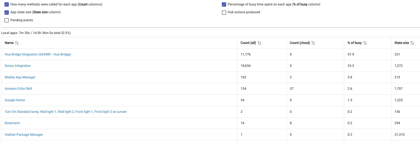

Are these helpful in any way?
At my advanced years I don't think I can handle any more additional apps when I am not understanding what is happening here
The apps will help you understand....
I am sorry, but at age 89 I have neither the time or energy to try to understand a new app.
The graphs you provide are meaningless to me and I can't help that

You have this in the upper left of your screenshot:
Screenshot 2026-03-12 at 7.16.31 AM
Your entire list of apps are using 0.5% of the resources.
You don't have "in view of the huge activity on Hue and Sonos Integration"
They happen to be at the top of a list and it's true, Hue uses 50% of that 0.5% (or 0.25% 'real')

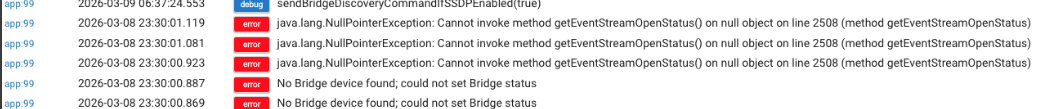

Those NPE's (null pointer exception) are where your problem lies in my opinion.
The bridge is going away, and presumably that causes the NPEs. Without a bridge, the hub won't be able to control those lights.

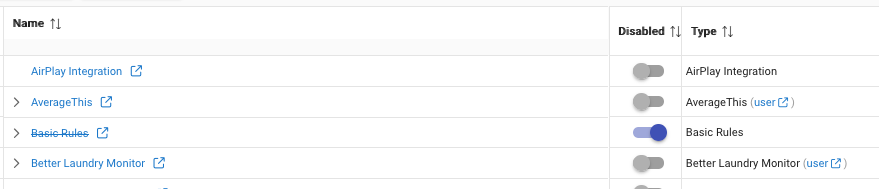

What is app 99 on YOUR hub? (Just click on or hover over, it will tell you.) I'd start by disabling that app.
If you don't have that column, click the gear in the upper right and turn that column on. Then disable app 99 and see if that helps with the need to reboot. Obviously if that is disabled, whatever it represents in your system won't function. If it's Hue, then those livingroom lights are disabled.
I'm trying to guide you through diagnostics. The graphs I'm presenting are for memory drop offs to see if that is what is happening. No one can magically tell you what's wrong without information which I'm trying to get from you. If you aren't willing to do things on a hub we have no access to, to give us info that would help us help you...well... We can't go much farther.
