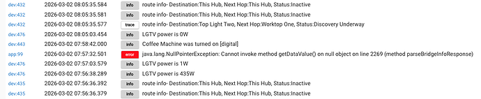

Here is a screenshot of logs around that time:
Hovering over the red "error" I get "Show details for app Hue Bridge Integration etc"
As you suggest, I am using a Hue lights paired to a Hue Bridge, but can't answer method of integration as this was done many years ago. However, clicking on the red "error" it opens a menu to "Add Hue Bridge Devices" which rather indicates that it is not integrated.

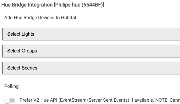

This is what I get on "Add Hue Bridge Devices"

Is that the built-in Integration, Coco-Hue or the Advanced Integration?
I do apologise for my ignorance but I don't recall and I don't know where to look to answer your question.
Under "Apps" I get this:
Screen Shot 2026-03-02 at 11.13.04
That's it... and it would show up in the URL when you clicked on the error in the logs...
Looks like you are using the built-in Hue Integration... I'm guessing the original... Ultimately one for the HE dev's to comment on...
