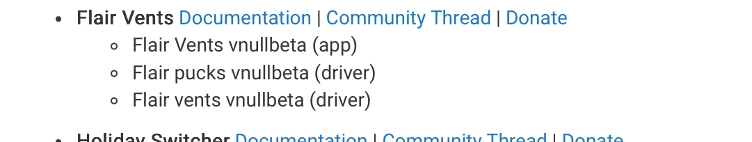

Edit: the link above is dead. And HPM shows this:

My HPM has gotten completely corrupted now and I don’t know how to resolve. I believe I have a beta Flair version and a main Flair version. The main version shows up in HPM as “vnullbeta”, per screen shot above. The beta version shows up as pv0.17.
I suspect the main version is actually your v0.18 but the HPM label of vnullbeta has me suspicious. And, I don’t see anywhere in your code where you have a comment with the version number indicated (am I just missing it?) so I have no way to doublecheck versioning.
Then, on the beta version, everything I try inside HPM (repair, uninstall, upgrade) throws fatal/serious errors that I can’t get past. As you can imagine, at this point, I’m prepared to delete it all and start from scratch but HPM won’t allow that either.

For anyone else using HPM with Flair, what version number does HPM show when you select "View Apps and Drivers" from the HPM main menu? I continue to see "vnullbeta" and am therefore concerned I have the wrong version.
Not working for me @ljbotero, although it could be just a labeling issue, per above.

@mluck @pomonabill220 - I found the issue with HPM beta access!
Solution for HPM Beta Access:
The beta versions require enabling pre-release support in HPM first:
  1. Go to HPM → Package Manager Settings
  2. Toggle ON: "When updating, install pre-release versions. Note: Pre-releases often include more bugs and should be considered beta software"
  3. Save the settings
  4. Go to HPM → Update
  5. You should now see "Flair Vents" with beta version 0.18 available
This explains why some of you were seeing "vnullbeta" or having issues - HPM wasn't configured to show pre-release versions.
Regarding the Issues Raised:
@mluck - The "vnullbeta" display is likely because HPM couldn't properly parse the version when pre-releases were disabled. After enabling the setting above, you should see the proper version 0.18. If your HPM is still corrupted, you might need to:
  1. First enable pre-release versions as described above
  2. Try "Repair" from HPM
  3. If that fails, manually remove the app/drivers and reinstall through HPM with pre-releases enabled
Version Numbering - You're right that version numbers aren't in the groovy files. They're tracked in packageManifest.json. I'll consider adding version comments to the groovy files in future releases for easier identification.

Jaime, in case it's helpful for you to know, this is not my experience. I had prerelease enabled in HPM, and still ended up with vnullbeta. In fact, because I was convinced I made some error, I wiped Flair clean (from HPM and from app/driver code) and installed from scratch and I'm still getting vnullbeta. Even ran repair, still the same.
I don't think it matters because I just installed your code manually, just pretty sure I'm fine, but figured you'd want to know. Cheers...

I did not have the pre release option selected, so I did, then ran update and HPM found the 0.18 version listed and installed it.

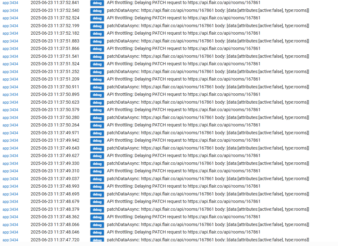

All of a sudden my log is going balistic with these entries!!!
This has been going on for about 15 minuets so far and is STILL going on.
All I mean ALL my vents are closed too and I have NO control.
I am going to try rebooting my hub to see if that sorts it out.
