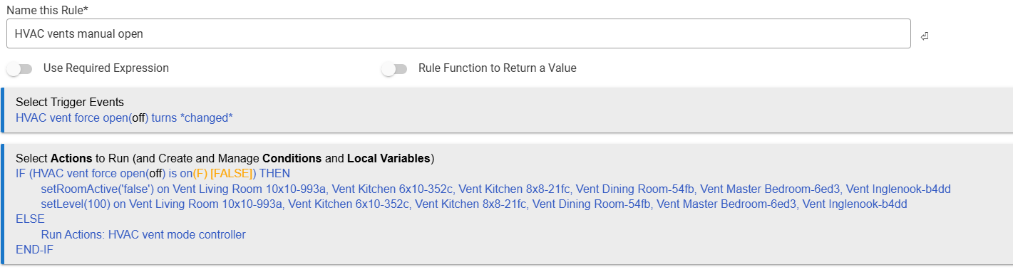

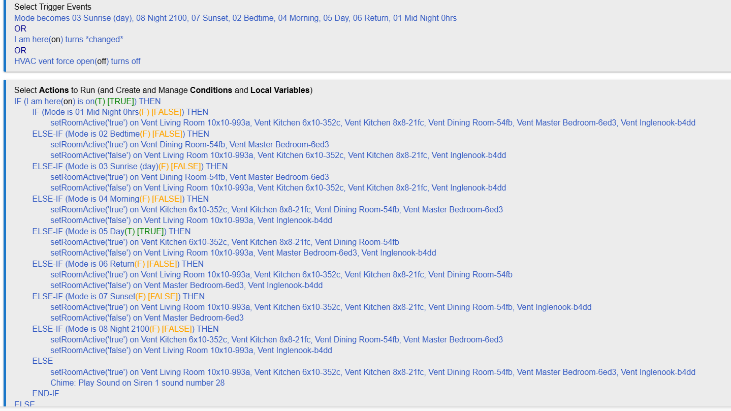

Could you post your rule that you use? I just want to see what you are doing and see if I am missing something.
I would appreciate it!
So I have disable all my rules that even touch my vents, except my rule to set all vent to inactive and open them all:
The trigger is a virtual switch.
The HVAC mode controller is:
I know it's a mess, but this is what I came up with for different modes and zones:
I have disable this rule also to test my vents.

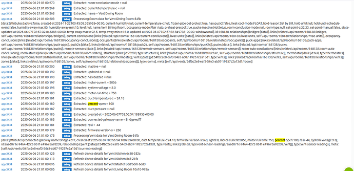

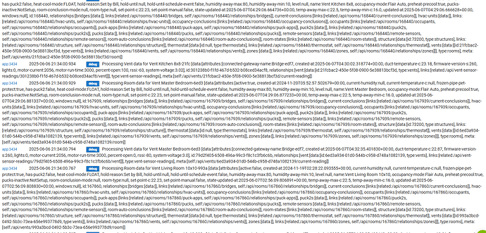

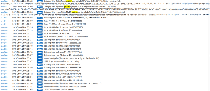

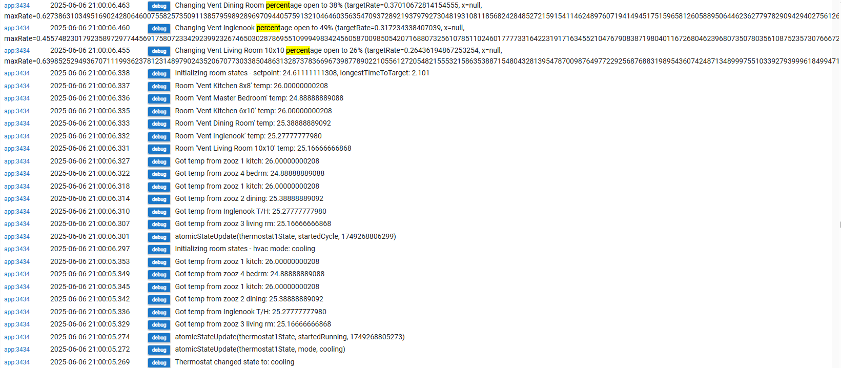

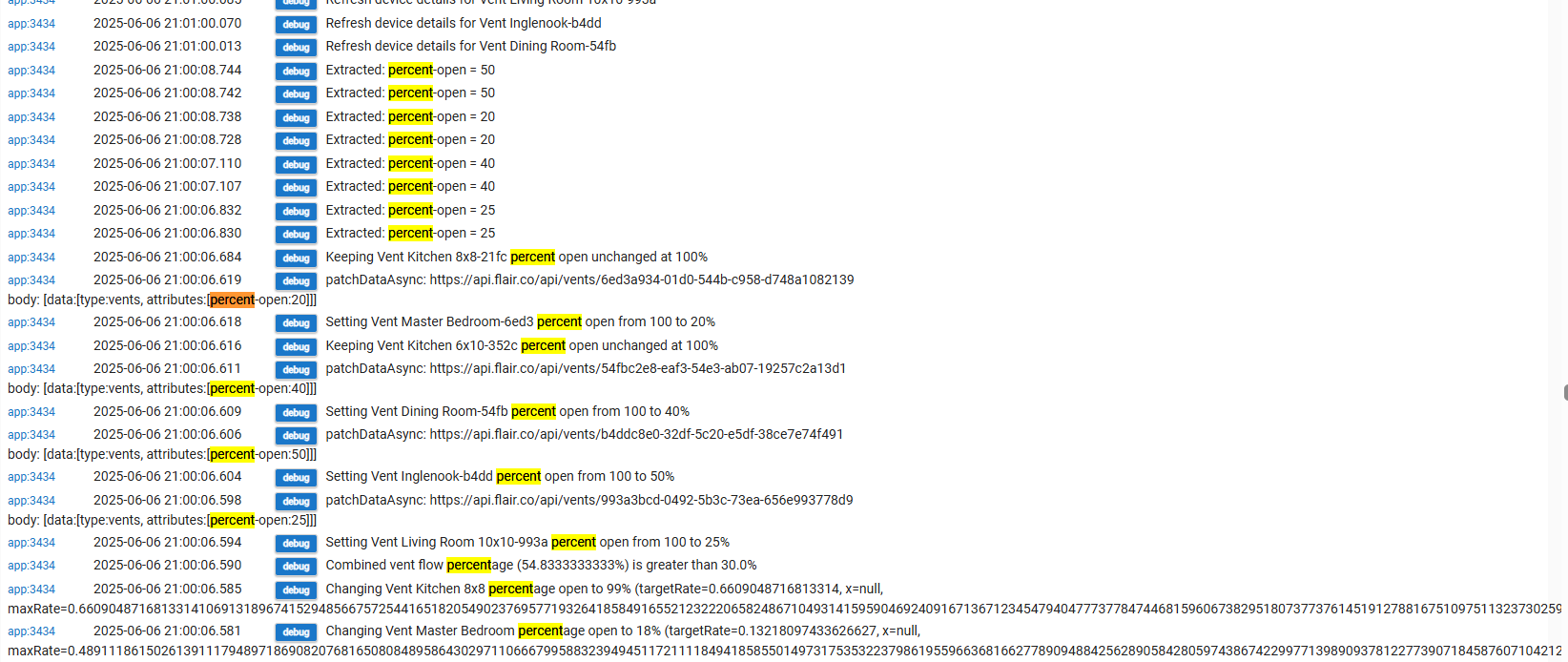

I was able to capture when the vents started closing, even though my switch was on and all vents were inactive and were at 100%.
Here are a few screenshots of the log:
My HVAC started calling for cool at 21:00:05 and that is where the vents operated even while inactivated.
So it looks like even though the vents are inactive, the vents are still being controlled.

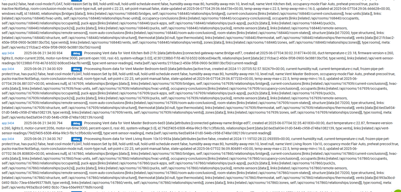

Well it didn't take long!
ALL rules that affect my vents have been disabled, except the flair HE app.
Dynamic airflow balancing IS turned on.
Close vents on inactive vents is turned OFF.

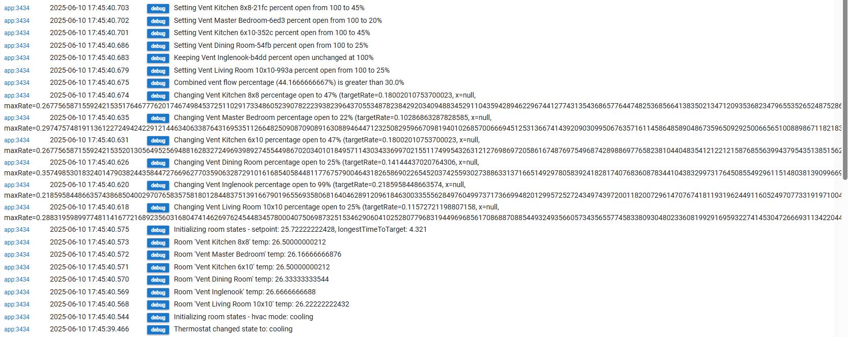

I did run my rule that sets all vent inactive and opens them to %100. This shows at the beginning of my log.
The vents still operated when the call for cool came on.
These logs are debug level 3

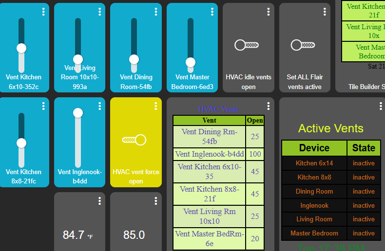

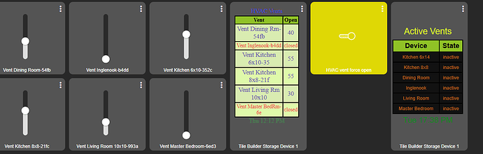

Here is a screenshot of my dashboard showing the vents all inactive, and their positions.

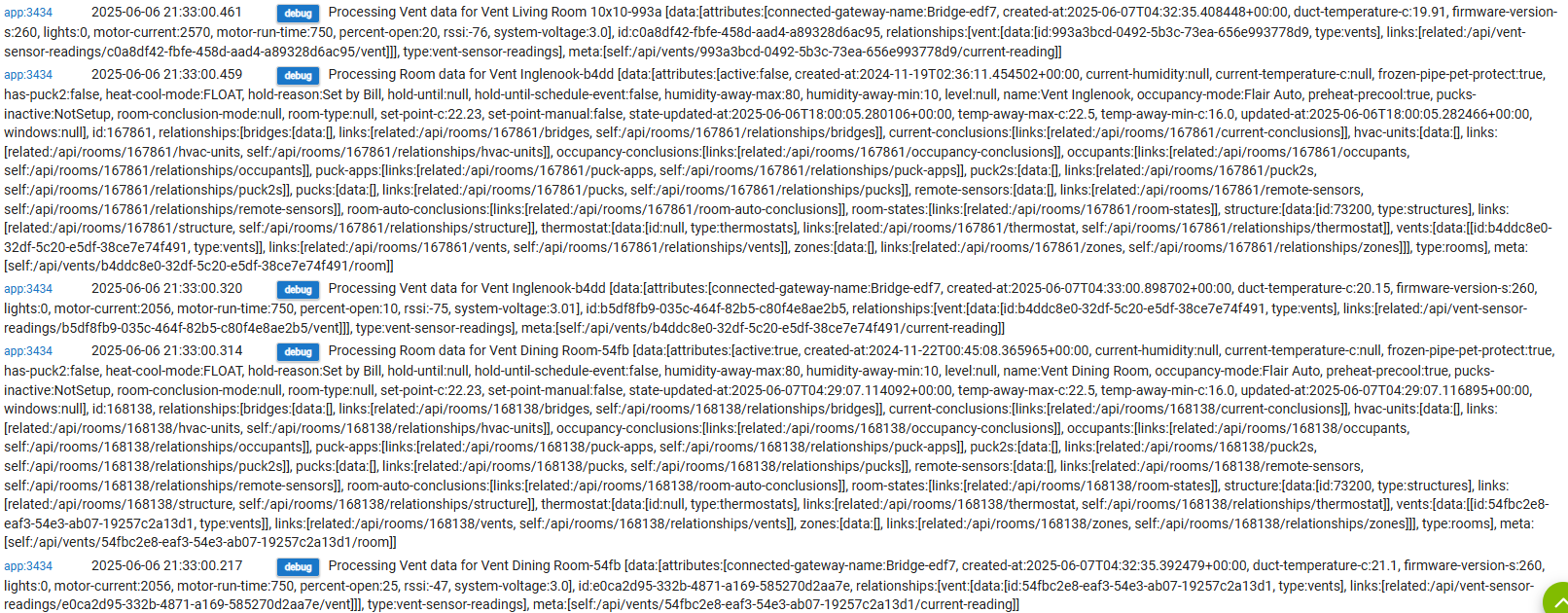

I am going to try forcing them open again, setting them inactive and disabling auto balancing and see if that is being triggered by the hvac calling for cool.
It appears that when turning off "use air flow balance", even withOUT a call to my HVAC the vents do NOT move.
When "use air flow balance" IS used,, even withOUT a call the vents move.
And even WITH all the vents inactive, they STILL MOVE!!!

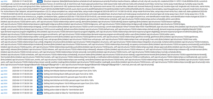

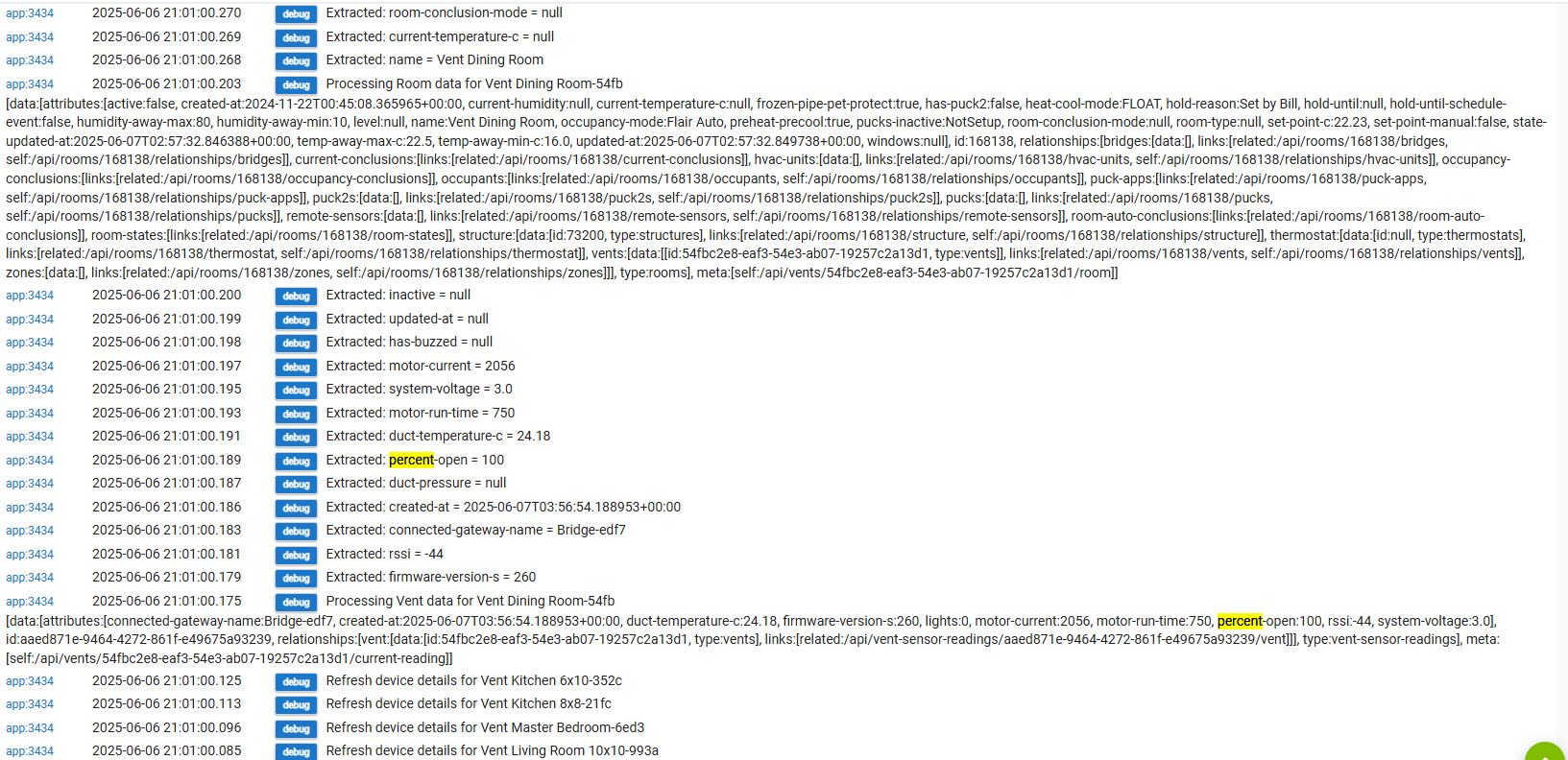

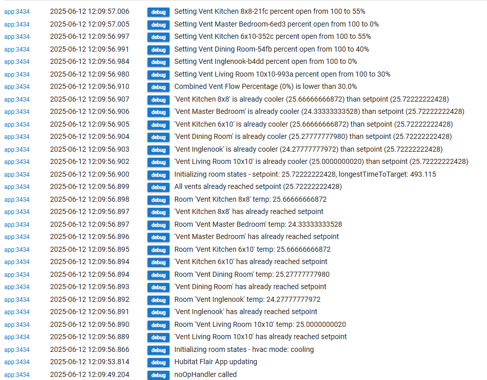

Here is the log when the "air flow balance" switch was turned ON. NO CALL to my HVAC!
I AM POSITIVE!!!!
and PLEASE PLEASE PLEASE.. WHY doesn't setting debug level to NONE not work!
The app STILL floods my logs with entries!
Just an update....

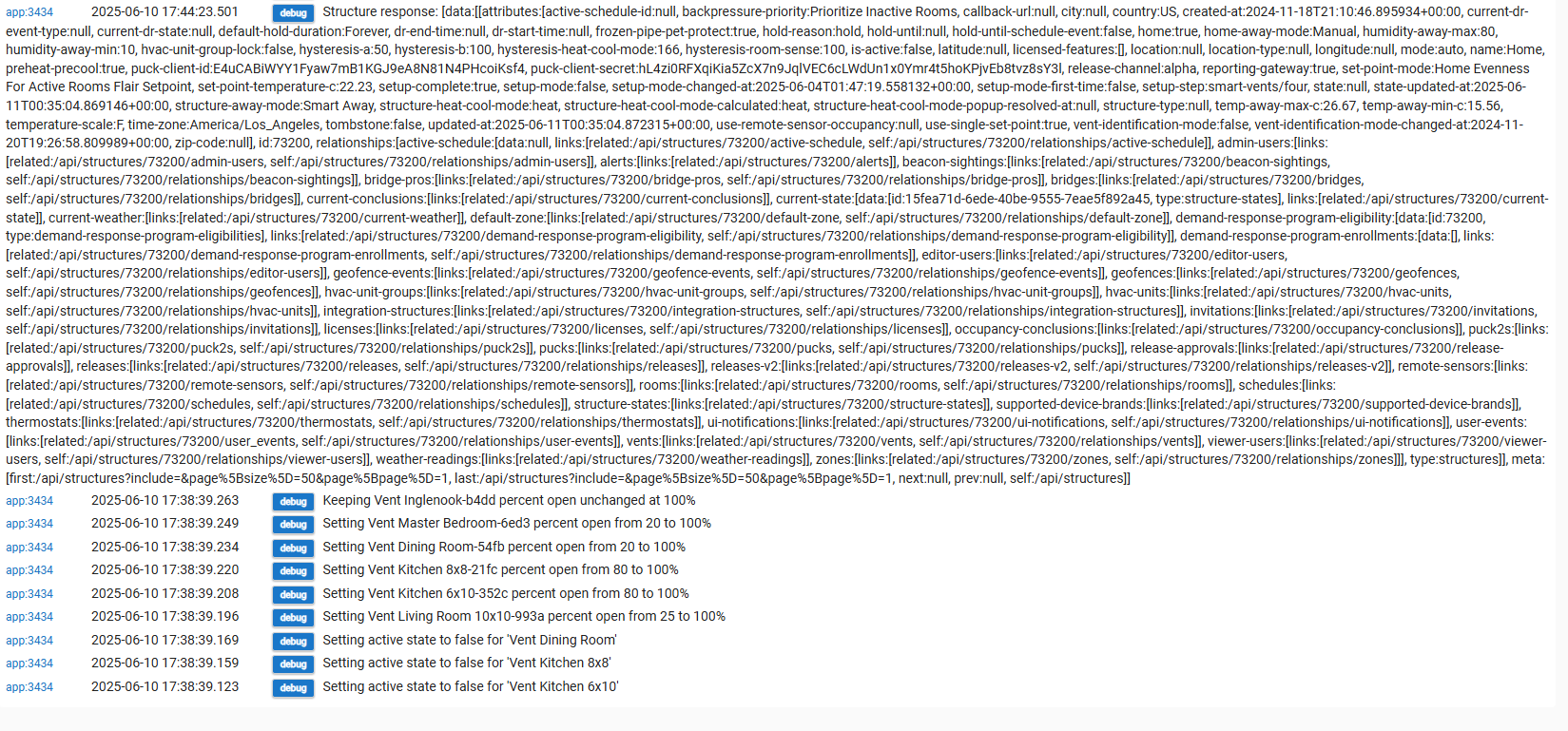

I found that if I turned off (disabled) Dynamic Airflow balancing, the vents never move and stay where they are set, either by my rules or their position just before balancing was turned off.
