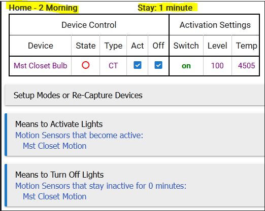

Since it was a simple rule I decided to just re-create it rather than using the imported rule. I was able to get the default to say 0 but then even with a per mode stay of 1 it still shut off right after motion stopped.
This is not how motion inactive works. There must be a motion inactive event for them to turn off from the Means To Turn Off of "Motion Sensors that stay inactive". The UI would be clearer if that said "Motion Sensors that become and stay inactive".
Basically, when you are turning the lights on from a dashboard or the device page, you aren't even running this app, as it runs from motion becoming active. You might want a different instance with Means to Activate of the light being turned on, and then use Elapsed Time to turn it off. At the moment, there is not a Condition to Limit turning off for motion, but I think we should add that.
