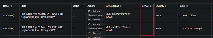

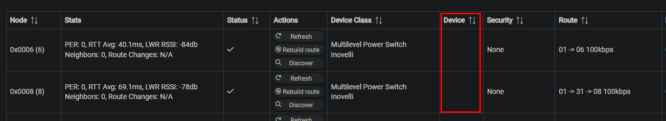

After the Radio reset and reboot, my Zwave details still has all my nodes, but they look like this:
Notice the device column is empty. Is that what's expected?
