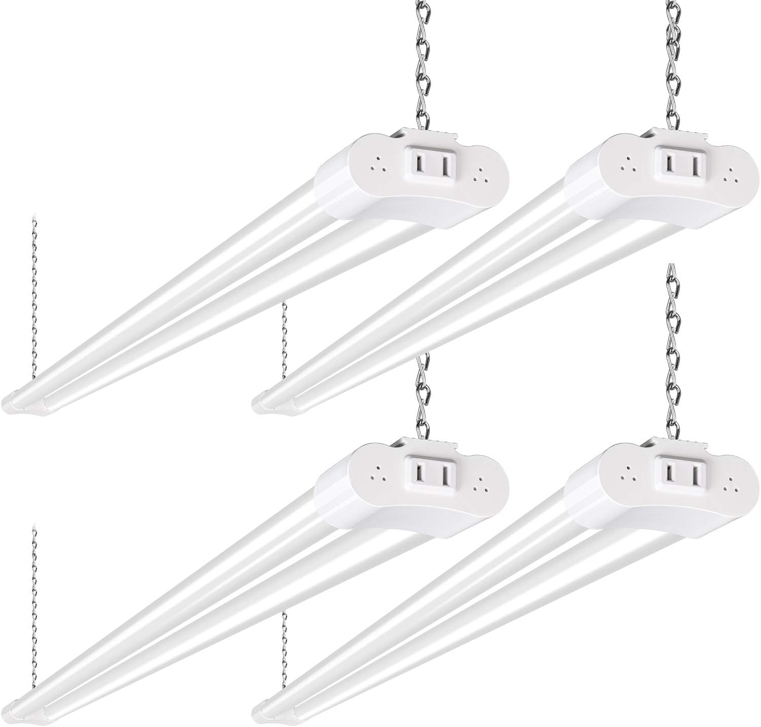

You might consider additional shop lights. I bought 5 from Costco when they were $20. Then operate them all with a zigbee or Zwave switch module.
To control them (on / off only) I see this switch is on sale now. Or maybe a single hardwired switch, can't say.
The Costco LED shoplights are very bright and each has a short pull chain so if you want to turn one or two off it is easy.
Just a thought.

Not sure if I have the same. Mine have an input cord on one end and a female AC receptacle on the other end. Turning off an upstream light by the pull chain does not effect the downstream lights.
Mine does not either but there are two outlets, one of which is for the sump, that are in the same wiring loop. So if I switched the hot on the entire loop for the lights the outlets would also turn off. I guess I misspoke earlier and they are wired in parallel but the outlets are within the same loop so they cannot easily be isolated.

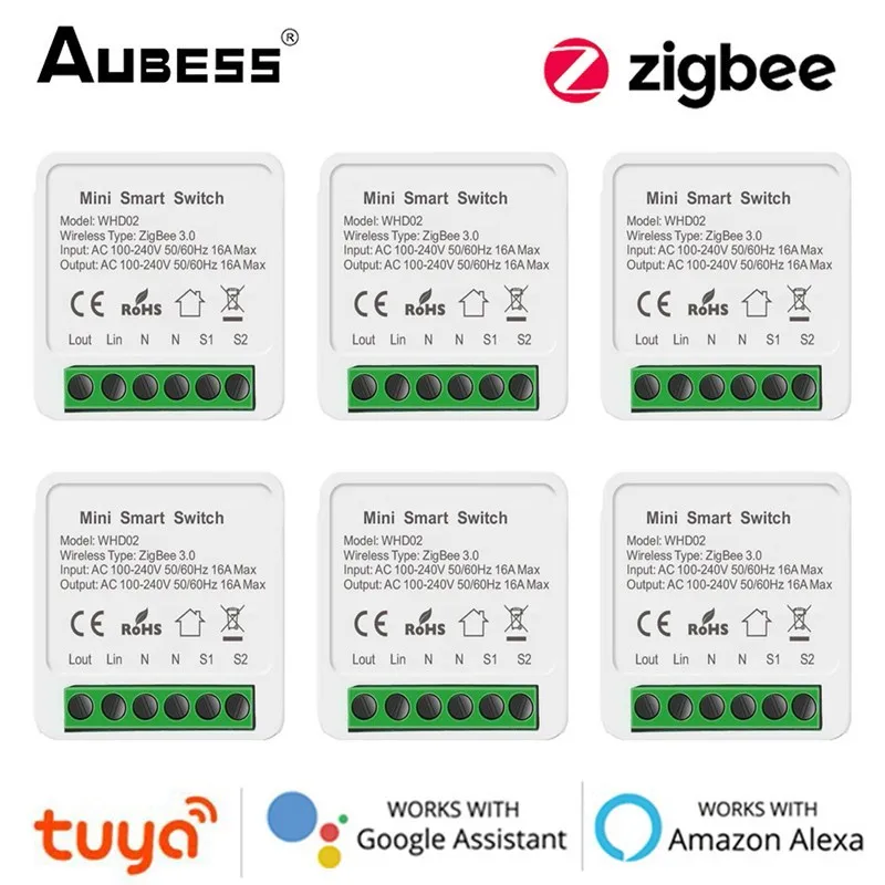

Similar basement ceilings. I put Sonoff ZBMINI switches in the box behind the light socket. Used a socket / plug adapter to connect some inexpensive led strip lights in a few basement locations triggered by motion sensors. I'd have to say I'm very happy with the result.
These inexpensive shop lights can be daisy chained together. Either chain or surface mount. They don't have anything on the sides so illuminate outward as well as down.

@bbrannon This might be a good solution for me. That zigbee switch is a pretty good price, might have to see if there is an even cheaper model without the 2/3 way options. I think I can even get multiple sockets with one as long as they are isolated from, and downstream, from the two outlets.
Could also daisy chain some shop lights off a single spot as you suggested and then abandon some of the sockets to reduce cost the number of smart devices. A few are not that far apart so two shop lights together could light the same area and only plug into one place.
@bbrannon can you explain a bit more? I don't quite get your setup. How did you connect the sonoff mini to the pull chain socket? Got pictures or some illustrations?
All of my basement lights were installed on a single circuit with no wall switch, all pull chains. The former owner had installed a few motion sensing sockets which I have kept in out of the way areas. The primary use areas are controlled by the Sonoff switches and two Hue motion sensors. The Sonoff mini goes in the backbox. It is quite small. I wired it so it controls the pull chain socket. Leave the socket on. I installed two different kinds of socket adapters, one with two AC outlets and one with two outlets and a pull chain as well. Connected led shop lights to both those. Nothing in the one socket and bright incandescent in the one with the pull chain. Turns out I've never turned that on.

I have finally done it over a year later!
Started with a Zooz ZEN51 mounted in the fixture connected to the 3-way switch. This allowed me to see when the switch was on and control the light. You could also use one of these cheap zigbee switches I think but I like having the button events from the ZEN51.
For the other fixtures I finally landed on some zigbee mini switches from AliExpress. Mainly due to the price being between only $6-8 each! Decided to try out two different ones, and they both work really well so far just have slightly different wiring. Just make sure you get Zigbee and not Wifi on accident.
Set it up so when the switch is flipped the stair light and one socket by the freezer turns on. This is all we normally need. Then if you flip the switch 2x quickly the ZEN51 counts it as a doubleTap so I have that turning on the entire basement. Setup a timer for that option so it only stays on for 1 hr.
