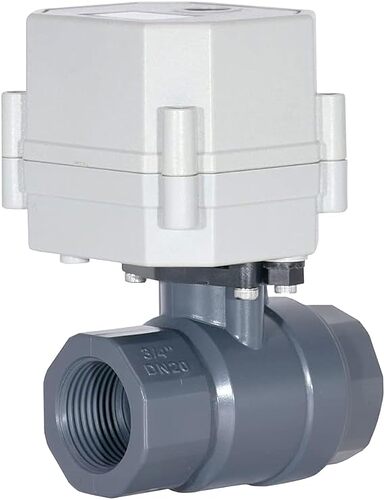

Thanks for the help. This is the motor I'm using:
It says blue wire (BL) but its actually green.

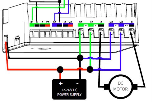

And this is how I wired the DC motor to the Zen17: Disregard the wiring on the top which are cut off on the picture. As you know those are for an optional physical switch, which I don't use.
Currently I only have the Red and black wires from the motor connected to the relay and not the sensor wires.

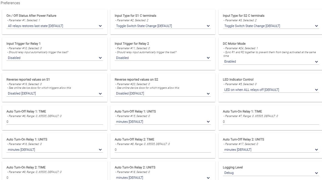

These are the driver settings I'm using:
Child device Relay 1 doesn't work correctly. When i try to open, it will open but then immediately reverses / closes. But child device Relay 2 works perfectly.
I'm not sure I understand when you said to "turn off the relay" I know what you mean but what parameter do I change?
Use the new driver, and those are not the settings I suggested to use.

EDIT: I read your info a little more. Looks like your device is an ACTUATOR not a DC motor. It is normally closed (no power = closed). You are trying to wire it like a DC motor which is totally wrong, if I am reading this correctly.
Your valve diagram looked strange so i googled it. It looks like this is an "auto return" type valve. As soon as you take power from the valve it will close. You need to hold power on the valve to keep it open. You should not be wiring this valve as shown in the Zooz diagram. Just connect the motor leads to the C and NO terminals of relay 1. Nothing gets connected to relay 2. DC motor mode setting is unnecessary.

Here is the motorized valve I am using:
I bought it on Amazon:
https://a.co/d/4vt5Vjg

Motor should be like this. The ZEN17 is just taking place of the switch and thats it.
You could wire B to the NC or NO, it will just reverse what on/off do. I think NO would make off on the relay = off (closed) on the valve.
Could also leave it on R2 if it is already wired and working there. Could flip A/B as well on the ZEN17 and it should not matter.

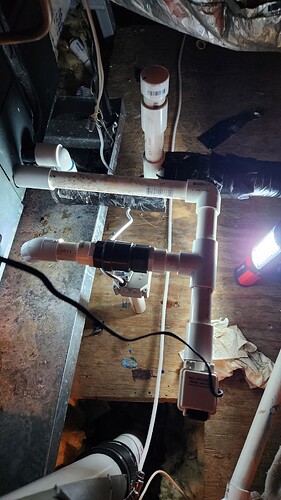

I agree. It's a long story but its not the main drain line. It's the line to the overflow sensor. I live in South Florida. my A/c unit is in the attic. Building code doesn't allow that anymore. It gets very hot up there and the drain line will clog often. When it clogs the sensor switch will activate and shut the system down. I can clear the drain line without out issue. However the line that contains the sensor switch continues to hold water and the system remains off. So, i have to get up in the attic, drain the line from the sensor switch and then the system turns back. Getting up in the attic is a pain in the ■■■. So i came up with the idea of a valve that I can open to drain the sensor line after I cleared the clog.
Here's a picture of the plumbing.
Thanks for the illustration. I think I got it. Should I stick with the current version of the companion device driver? I saw the "Alpha" version but didn't know if its ready for "prime time"
Makes perfect sense, your secondary overflow drain does not actually go anywhere, just to a kill switch. So you have a valve you can clear it out back into the pan. Good idea actually.
