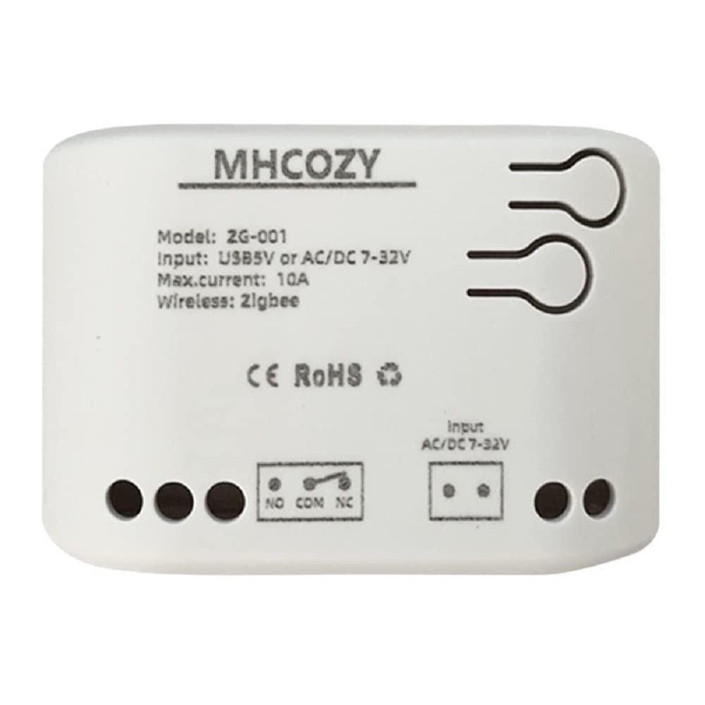

Here you've included a picture of a zigbee MHCOZY relay... But in your other thread, you pictured a tuya wifi relay.
Do you now have a MHCOZY relay (to replace your tuya WiFi relay)? Or do you have a Zen 17?

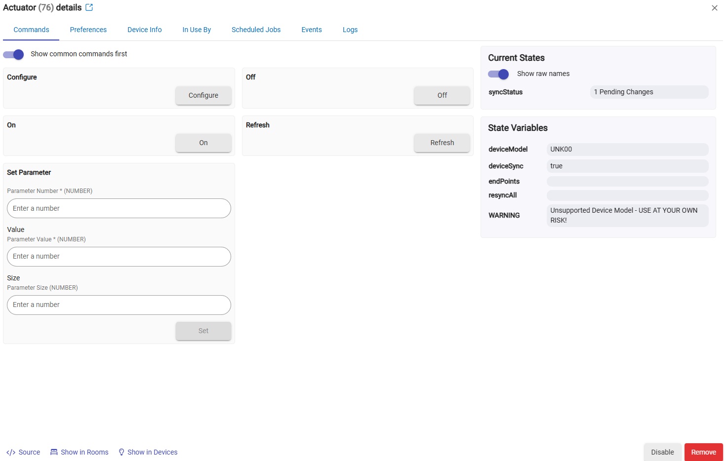

I just received the ZEN 17 I added in hubitat but I don't know how to fix it, it's stay at off

My driver is not recognizing your device as a ZEN17. The device you have a picture of at the top is for sure NOT a ZEN17, if that is your actual device...
Please go to the Device Info tab and get a screenshot of the "Device Data" at the bottom.
Yeah, that "Unsupported Device..." note caught my eye too.
And I'm now 99.9% certain that the OP has that MHCOZY, not a Z17...
In this post of OP's original thread, JasonJoel mentions that he uses a Z17, but he posted an Amazon link to a MHCOZY -- I'm sure his intentions were simply to link a zigbee version of a relay that was otherwise very similar to OP's tuya wifi relay.
I never actually clicked JasonJoel's link until just now, so yeah, I'd bet anything that's the story here.

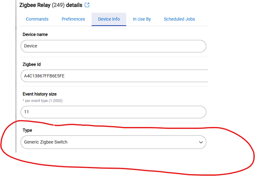

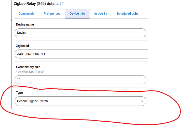

If you have the MHCOZY zigbee relay (and not the Zooz ZEN17 zwave relay), then change the type to "Generic Zigbee Switch" in the device details -> Device Info tab, and save it. There isn't anything else that needs to be configured.
Example:
You can then execute ON/OFF commands to the relay on the Commands tab or from rules, etc. You should hear the relay click when you issue the ON/OFF commands.

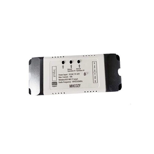

I try to add the MHCOZY 2 Channel 5V 12V 32V WiFi Relay Switch,Tuya app Remote Dry Contact, I try with MHCOZY relays, Zooz 17, Zooz51 and no one works, please help
This WiFi device is not supported by Hubitat.

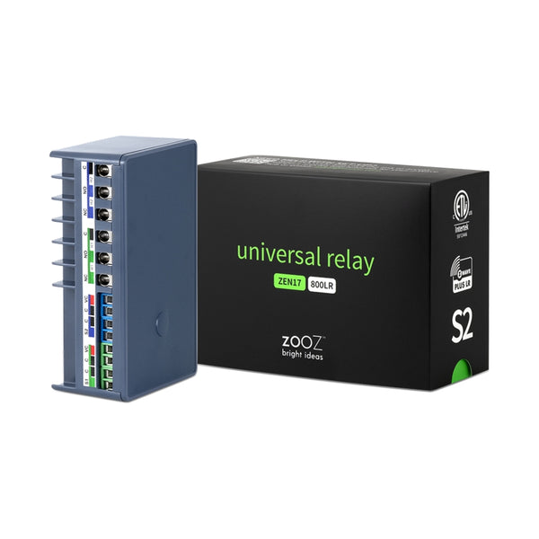

There's a zigbee MHCOZY relay that will work with Hubitat. However, it will not work with Zooz Zen17 or Zen51 drivers - those are z-wave devices.
If you are in North America, this is the link to the product you apparently need - the Zooz Zen17.

Thanks I will order the ZOOZ 800 and I will return the MHCOZY 2 Channel to get a refund.
