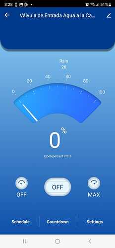

Work in process (not finished yet ):
If there is a web site version of the app you could grab the URLs from it and build something, otherwise you’d be looking at trying to sniff the app which is normally somewhat of a niche skillset.
There is no full support for all functionalities available for this valve when using the Tuya app, but probably a simple on/off control will be possible from Hubitat.
You should be able also to link the SmartLife app to your Amazon account and can control it from Hubitat using a virtual switch as well.

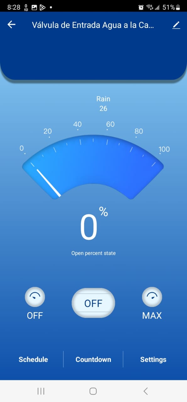

On a side note, I think it's interesting that the app provides % open. I've never seen that before.
