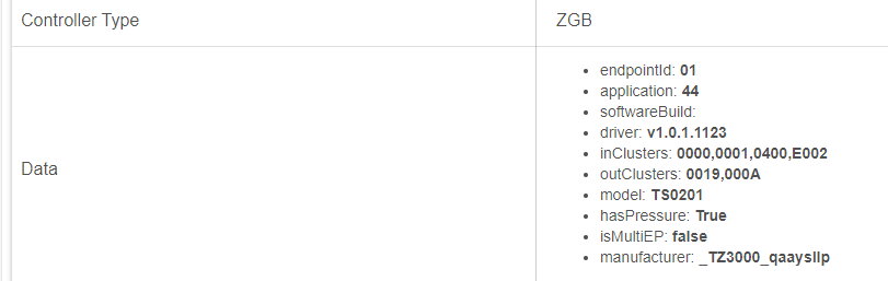

Here is a little more info on the device from the device settings:
I found a little more inside the logs:

However, I thought of something I had seen in the past and did a bit of checking. Is you unit the one THIS thread is about? I think they got it all sorted out with a driver there. Hate to make you sit through my figuring it out if there is one.
If there is not, I will still try to get this one working. Need more samples of what it responds with, that is for sure. Since it is obviously not responding to the normal ZigBee areas for temperature and humidity (but does for illuminance... so odd).
