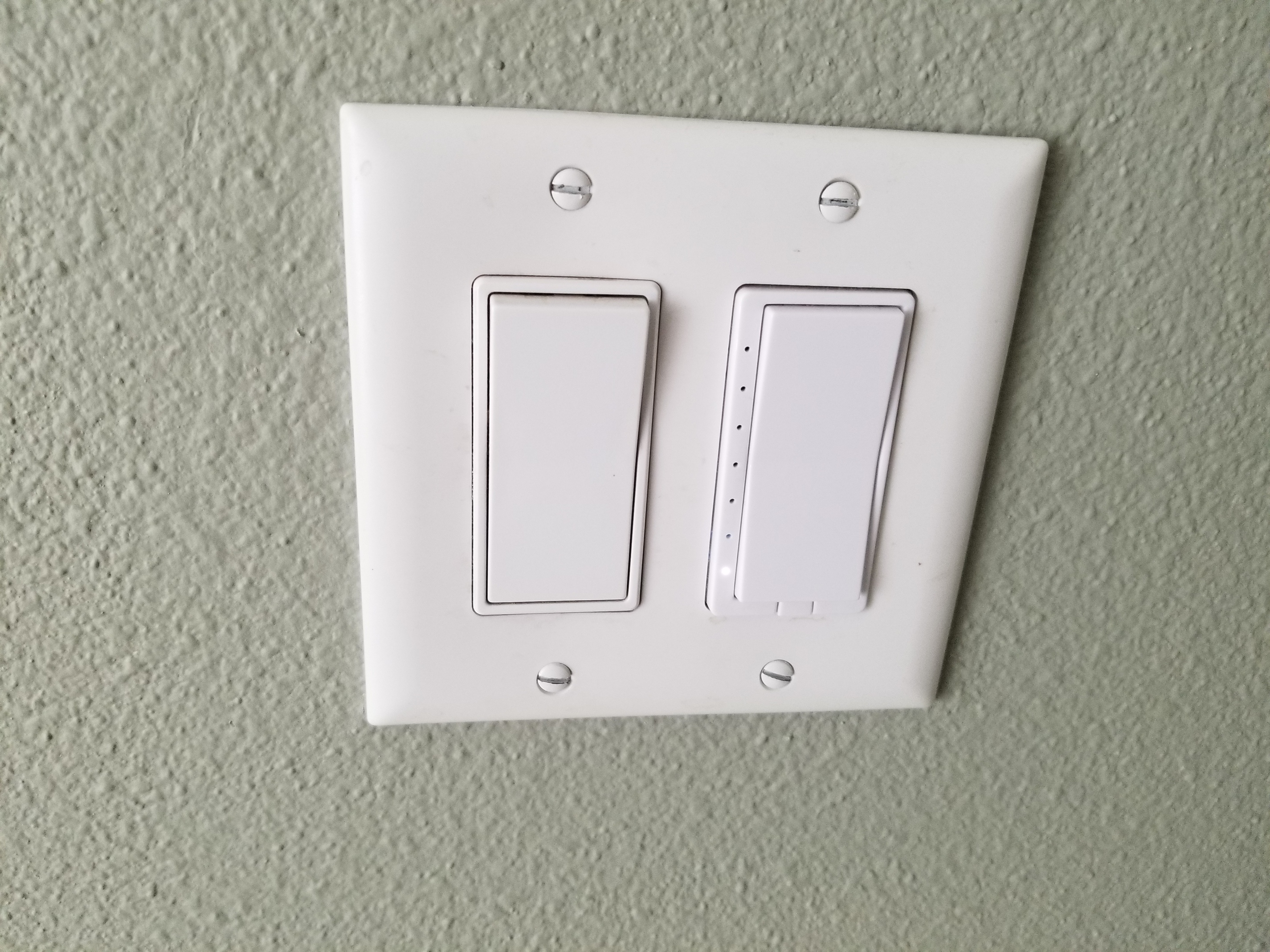

How does the white color of homeseer compare to the GE? I noticed the Zooz for example is brighter.
The homeseer switches were whiter than the white switch plates that were installed in my home 15 years ago. Made the old switch plates look a little yellow. I just replaced all of the switch plates with new Lutron Casetta plates last week and the color is spot on with the switches. They look a little more modern as well since they hide the screws.
Awesome thank you for pictures. How is the click? I find the GE like a rocker switch where you push it a bit but the Zooz is barely a click.
They are fairly short throw, but have a high quality feel. Feel much better (less wiggly) than the Leviton dimmers I have. Not squishy at all. firm click.
