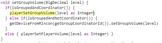

setGroupVolume requires an additional cast as well. playerSetGroupVolume requires level as an Integer, or it throws an exception.
