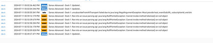

OK. Thank you for that. I had to hit "create players" 6 times before all 6 units were added. Each time I hit the button, the next player was created, but I am still not having any luck with controlling from the Hubitat.
If I do anyting on the Sonos App, the change is reflected in the Hubitat, but I have no control over anything from the Hubitat. I have hit "initialize" and "save" on each device just to be sure.
I have attached a log from the one speaker and the controller. Something is really goofy here, cause I have now tried to get this up and running in three locations, and they all have the same issues. Two are S1 and one is S2. The worst thing about all of this is it did work in one location in the early days of this project. Something has to have changed.
(and as I said before, both the Hubitat native Sonos works, and the Sonos App(s) works)
