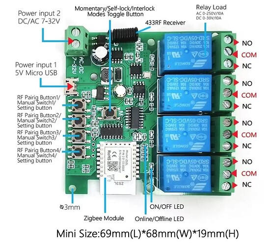

Not sure what sort of keyfob these support, documentation is pretty crap, but possibly could also do the job.
4 channel ZigBee RF Relay
I saw that. But it wasn't very clear as to what kind of keyfob and I didn't want to take a chance not knowing.
Totally agree. More of an option if you already have Lutron lights integrated into your HE environment.
Found this on Ali for under $3. For that price I am taking a chance.
Looks like the MHCOZY 4 channel relay that many community members are using. There is an inbuilt driver for it too.
Didn’t realize others were already using it. Good to know. First I heard of it was the post above by@ranchitat
I found out about the MHCOZY relays from this 2021 post and Release 2.2.9 included drivers for it as @PunchCardPgmr mentions:

Gonna try the MhCozy gizmo with a fixed code remote I picked up for $6. For a total less than $10, will be fun to play around with.
I read somewhere that there is a downloadable manual for the MH cozy. Anyone know where I can find it? Not having much luck searching for it.
I only own the 1 and 2 channels. You might want to post that question in the thread I mentioned above to see if folks have the 4 channel manual they can scan for you.
