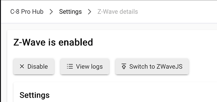

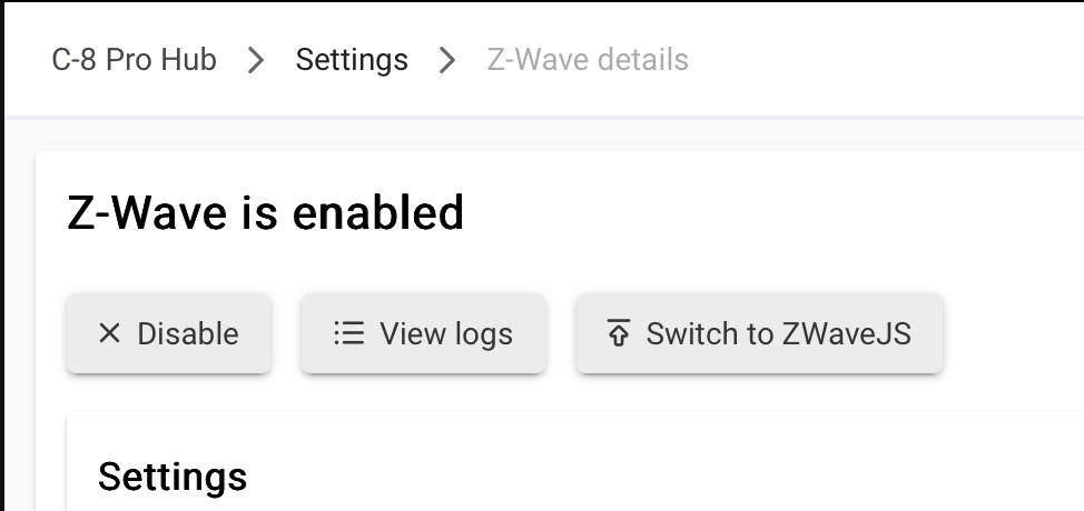

I have no idea if this could help, but do you have ZWJS enabled?
I do not. When I click the switch to ZwaveJS button, it says that to turn it on, the unit needs to reboot. Im using US-LR 908.4 Mhz, 916 Mhz band.
I turned it on to see if that would correct it but it did not. I left it on. I did build a new menu with the ez dashboard. It created the switch and sends it on, but it does not work there either. Thank you for trying to help can you think of anything else I might be missing?
