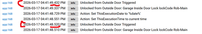

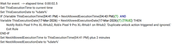

Any better ideas (the Private Boolean for this rule has another purpose, btw)?
Note: prior to putting in the "Wait for Event", it triggered twice within a second and both triggers ran the rule because it didn't have time to set the "time check" values.

If you are already using the private boolean for something else, maybe create a hub variable boolean (Call it bnLockWaitOutsideDoor or similar) and use that as the required expression?
First step, set it to false
wait for event elapsed time 2.5 seconds
Rest of rule
Last step, set it to true

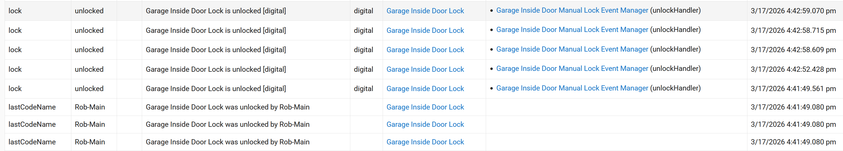

if the problem is coming from the device as @tray_e indicates, then the best way forward would be to "debounce" the lock. If it isn't straightforward to modify the driver code to flter extra events there, you could write a rule in RM 5.1 or a custom app, to set a virtual ("debounced") lock from the true lock.
Without seeing debug logs from your device, it's impossible to say, but if one of your duplicate events from the device (that's probably where it's coming from; without at least descriptionText logging from the device or a look at its Events history, it's also impossible to say -- but the Rule logs suggest it's not really a Rule problem) is a Door Operation Report, there is an option in the Schalge driver to ignore those. I bring that up since you mentioned it's what you're using. May or may not be it, would take some digging into what's really happening for you when to say for sure, but worth looking into if you don't want to try some other approach!
From looking around, however, it appears that enabling that option prevents the hub from recognizing lock/unlock state changes when they are digital (from the hub).

Did you try this on your specific device or at least enable debug logging to see what Z-Wave reports come in when? There are many hardware and firmware revisions of these devices floating around, and they problaby behave differently. (I'm sure this happens for someone/some combinations of these, but I believe it was added to address cases where things like yours happen. Debug logs would be the best clue beyond just trying.)
