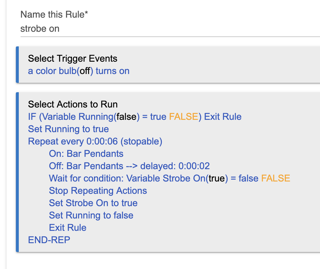

There are a number of problems with this. One is to avoid having multiple instances of the strobe activation rule running. Another is how quickly you can retrigger the strobe activation rule. Consider this pair of rules:
Note that the first and last actions are the mechanism to prevent multiple simultaneous instances.
The problem with re-triggering this is that there must be 6 seconds after one loop starts, before triggering it again will work. There is this short dead zone. Turning the switch on during that period would not start the strobe because it will not have reset itself yet.
This doesn't seem like a complete solution to your statement of the problem to be solved. It's going to be tricky to figure out.
Ah, progress. This pair can be retriggered without the 6 second dead zone:
By putting the Wait in the Repeat loop, it's going to catch the change in the controlling variable, Strobe On, as soon as it happens, and reset the rule for the next go. The Wait itself is cancelled and renewed each time around the loop. The Wait doesn't stop the loop from running every 6 seconds.
This one seems pretty robust, banging away on the switch....

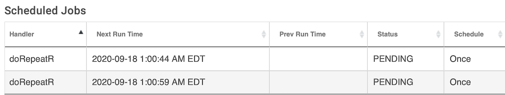

Well, that rule will can get more than one repeat going too. First, here is what I have entered, just so you know its the same as yours…
Notice I am using a 30 second repeat time. I suspect your 4 second time is making it hard to see anything unusual.
I suspect almost any rule with a ’stop repeating actions’ can have the problem.
Change your repeat time to 30 seconds. Start the rule, let it run to verify it’s flashing your lights, then stop it shortly after the lights flash.
View the scheduled actions and you will see there is still one there, as if it was going to keep running. But when that scheduled time arrives, the lights don’t flash, and refreshing the page shows there are no scheduled actions.
Start the rule again. Shortly after the lights flash, stop it. View that scheduled job’s time.
Before that time arrives, restart the rule. You don’t have to switch it off/on real fast, just be sure to turn it on before that scheduled time.
Watch your lights, they should be flashing more than once in 30 seconds. And there will be 2 scheduled jobs. It's running two repeat loops at once.
Like this…
I have seen this with the other rule you made also. It isn’t just happening on my system, I was helping someone on a week or so ago who was using a 40 minute repeat loop and wanted to be able to stop it before 40 minutes and reset it for 40 minutes from now. He showed a screen shot showing two scheduled actions.
Obviously if you can reproduce this you will be able to figure out exactly what is going on, but here is my guess…
Stop repeat action doesn’t remove the scheduled job, instead it creates a setting that will stop it when it tries to run. I found a setting on that page called stopRepeatMain, and it was set to true after stopping the rule. So I think that might be what is stopping the scheduled job. As soon as I started the rule again, that setting switched to false. As you have explained, there is only one state per rule, so this must be part of that.
With that off, the existing scheduled job doesn’t get stopped and when the restarted rule starts its repeat, that creates a second repeat that is also running.
I might be way off base on all of that, but I know for sure that it’s not that hard to get 2 repeats going at once if you start the job up again before the existing scheduled job goes away. You need to try it on a slower repeat, I’m not sure you can see it on a 4 second repeat.
