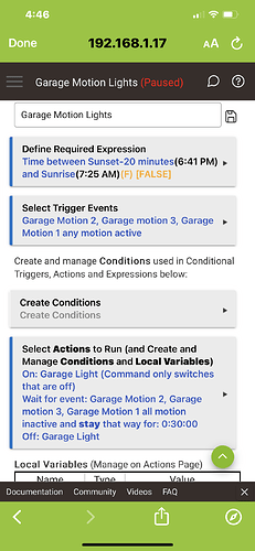

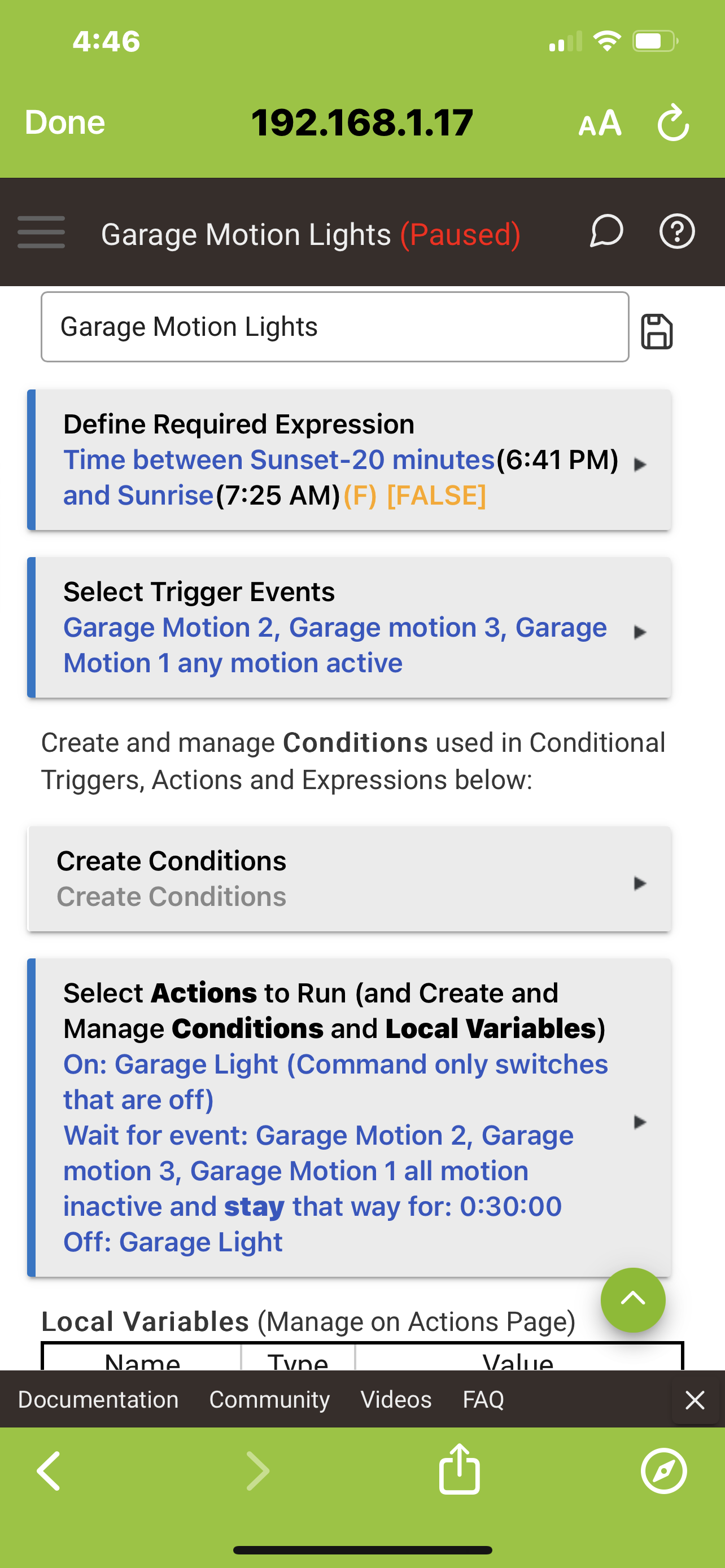

I have a rule for garage motion. I have been using the Motion lighting App but it seems to not turn off the lights when already on. New condition. So. I have a RM set up.
My goal. Tune on lights, if night, when motion if detected. Wait for motion to be inactive for 30 minutes.
Should this rule run even if the light was left on or turned on manually ? What I’m having issues with is that if the light was manually turned on and/ or left on before night. They stay on all night and seem to ignore motion inactive.

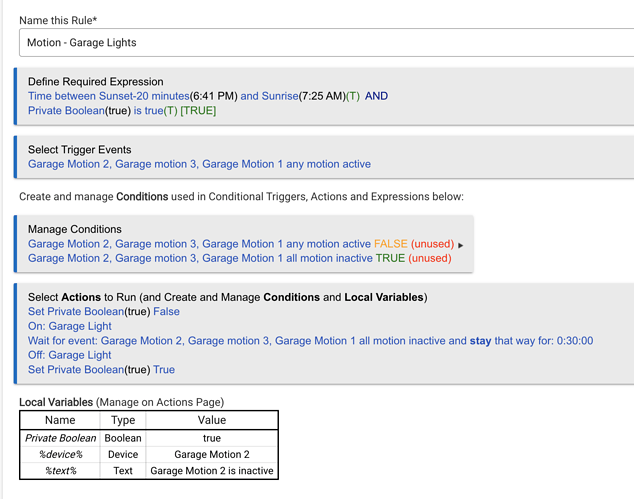

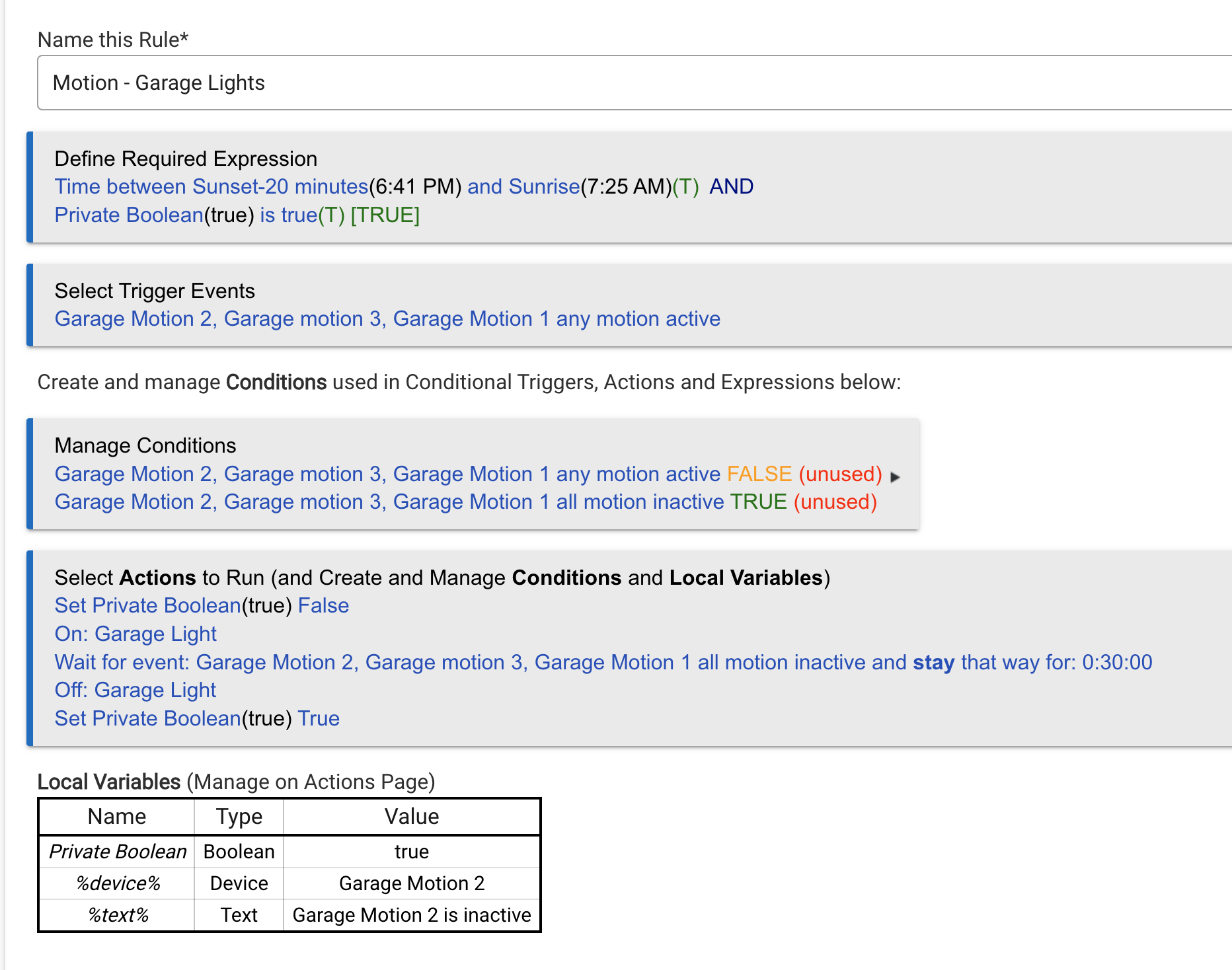

Sorry. I meant to attach when I posted. It’s been updated and attached.
Your rule looks fine; though, it might need a slight modification to prevent it from running multiple times. You might want to use a Private Boolean as true in the required expression. Then, your first action is set the Boolean as false and your last action after the light goes off is to set it to true. This way, your rule only runs once.
With that said, my suggestion of a second rule would help set everything up. Have the trigger be sunset-20 and check the status of the light and motion sensor. If the light is on and motion sensor is inactive, have this rule turn off your light.

Not quite. If you stood perfectly still so that the motion sensor went inactive, the rule would trigger again with any motion. Now this would cancel your original wait due to the rule retriggering. Basically, it would reset your rule. If this is desired, then you do not need to add the Private Boolean. Some folks do not want this behavior, and as such, add the Boolean to prevent the rule from triggering again.

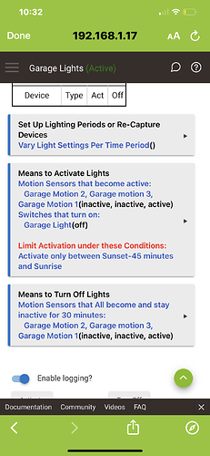

Found it, was a little overwheling at first but I see the idea behind it. I moved this to that app. I was buidling others based off wait events, with mutiple steps in-between. Im slowly moving them to the Room lighitng now, for its function wihtout building, and testing, detailed rules.

Got it orkin- I added that messign with it.. I deleted t he APP and reinstalled this room.
One thing I noticed, if it only activates during night, does this mean the if the switch is manully tuned on, it will not turn off if mpotion is not present durign the day?
Remove the ā€œdon’t activate if turned off manuallyā€ option. This is preventing the motion sensors from triggering if the last time your turned off the lights was manual. You want to have basically the same options selected that was in the example.
I added that while messing around with it.
I’m in the garage now and the sensors do not show active in the app. In the devices, they are.
