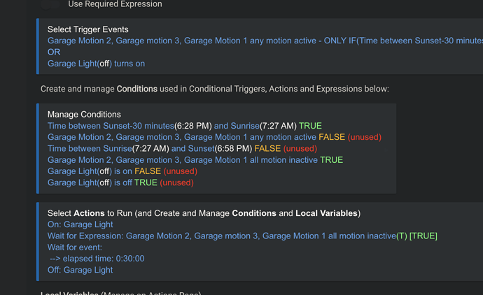

Your screenshot shows that Room Lighting is already active. Does Room Lighting turn off after the 30 minute stay? If so, then Room Lighting is working fine.
I’d say the larger issue is that your light is not registering in the device table. Room Lighting needs that in order to Activate and Turn Off the device.
I removed this app and reinstaleld it. Works now.....
So, because I added " limit activation while from sunset to surise, will these prevent the lights from turning off with no motion,if manully turne on, durign the day?
Yes, but you’ll be repeating the same issues you had with Rule Machine by having it.
Yeah, I have encountered that..... :frowning:
So, im going to test this and see if it work as intended without having to make two room rules.

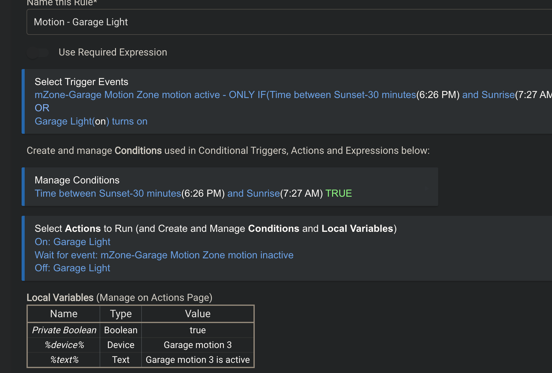

That should work the way you want it to. Your light would get an off command even if already manually turned off, but that shouldn't affect anything. The one thing I do recommend is using Zone Motion Controller | Hubitat Documentation to create a single, virtual motion sensor that contains all three of the garage sensors. It would just help clean up the rule a little bit. If you set it for an Activity Timeout of 30 minutes, your actions would be:
On light
Wait for Event: Virtual Motion sensor inactive
Off Light
Good call- I set this up as a zone before but did not ever use it..
One issue is activity within zone controller, it still calls for active versus not active in the RM.
