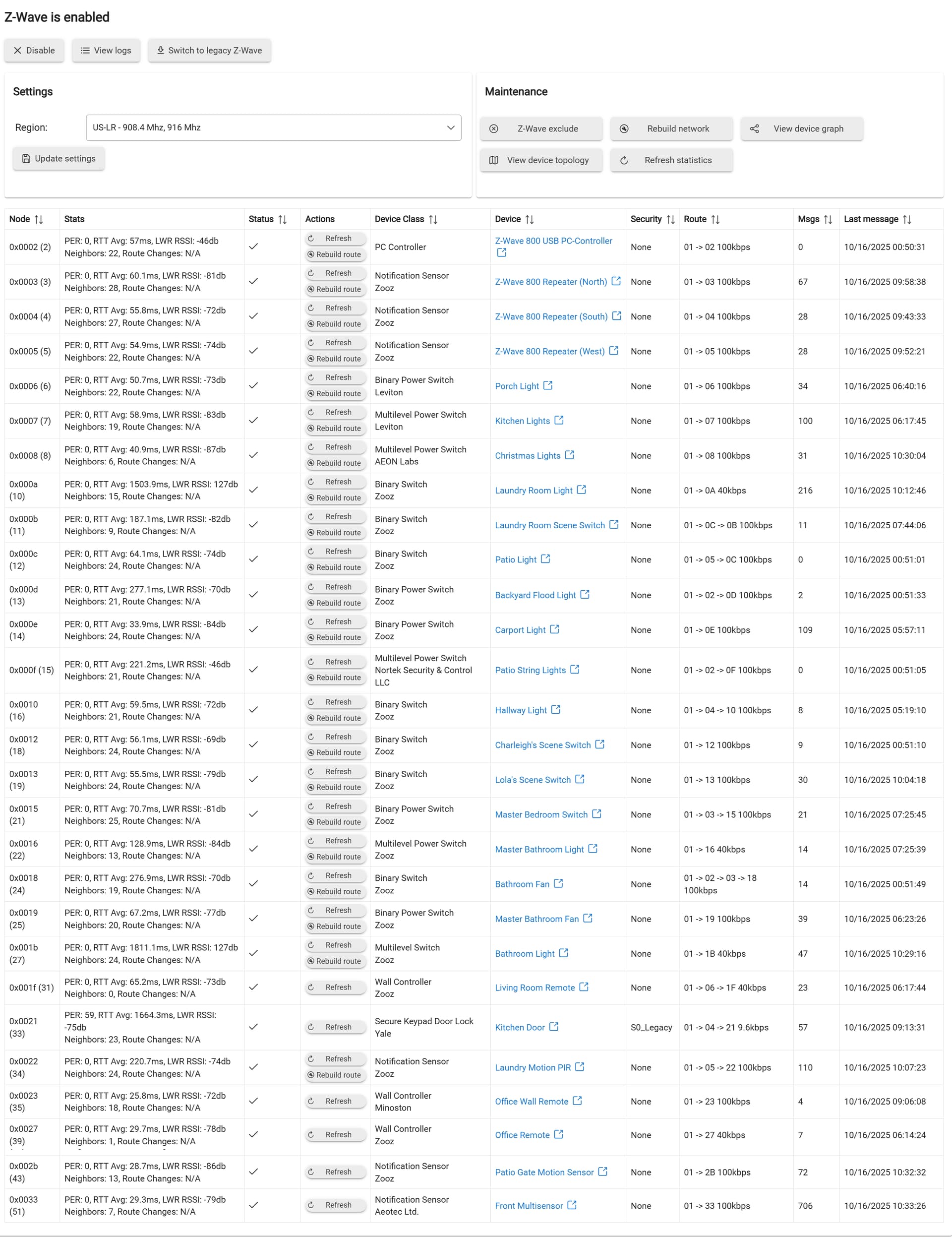

But, since I have been having issues for ages, here's the Z-Wave details page and maybe there's something weird I just dont see:
Platform 2.4.3.137 on ZW-JS
as far as things you may notice: node 21 has a very low data-rate but it seems to work reliably with no issues. node 33 has a ton of messages but its a motion/temp/illumination sensor (Aeotec Tri Sensor) and seems to work perfectly fine.
0A, 0B, and 0E are consistently lagging or entirely failing to react at all. I'd say it's about 50% of the time they work fine, 50% of the time they take several seconds to react or simply dont react when commanded.

Check the devices with the higher RTT (other than the lock which is somewhat normal). The high RTT might be coming with retries and route changes, which all bogs down the mesh.
Also, how long was hub up since reboot? The 57 messages for the lock is a lot. Every time you action that lock from the hub it can stall the mesh for up to 60 seconds while the FLIRS beam is going out. Do you have automations setup for the lock?
Laundry Room light 0A has a high RTT and a lot of messages. I am guessing it is automated in some fashion, going on and off a lot.
Are you using command retry at all?
About 45 hours ago when I updated to the latest official platform release.
Yes it is automated, and it's our main entryway in and out of the house, so it gets manually locked and unlocked quite often by hand which produces a status report each time as well. But I have an automation that automatically locks the door if it was left unlocked and nobody is home, or at night if it's unlocked for any longer than 6 minutes it will automatically lock then too.
Yes, the laundry room light turns on when the laundry room door is opened, and turns off after 5 minutes of no activity in the laundry room if it is left on. This automation in particular often shows the lag in the system. When I first set up the automation, the light was on instantly when the door cracked. It generally takes 10-30 seconds nowadays (about 50% of the time). The thing thats weird is the Laundry room is literally filed with Z-Wave repeaters. It has 6 mains powered devices scattered throughout the room.

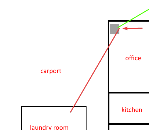

Post a picture of where you hub is located. Looking for any possible interference.

Does your layout above imply that the signal has to go through two external walls to get to the laundry room? House external/laundry room external? Looks like it also has to go through the rack to get to that area as well. Also, if cars are parked in the carport they also might affect signal transit... :man_shrugging:
Here's an actual picture to show the proximity between the office and the laundry room. The external wall of the house is block, the laundry room is just siding and framing, no drywall or anything. The block construction of the house doesn't seem to be a problem for other devices which are much farther away, with the entire house between the device and the hub.

I personally am leaning towards a bad device in the vicinity of the laundry room. I have two older devices. One is an AeoTec Smart Dimmer 6 (plugin style dimmer) and the other is a GoControl dimmer (in wall style paddle switch/dimmer) and both are using older generation zwave chips (500 maybe?).
Of the three problematic devices I've mentioned, ALL of them are located IN the laundry room. Two are right next to the door in the same plastic switchbox, and the other is located in another switchbox on the back wall of the laundry room. Besides the three problematic devices, there's also the two old dimmers I mentioned, a zooz zen32 switch/scene controller, and 2 Zooz PIR motion sensors (battery powered during inclusion but now powered by 5V DC USB supply). So that's 6 mains powered Zwave devices and 2 non-repeating devices scattered about one small area. Of those, the three newer Zooz switches (700 series I think) are the ones having problems.

Something else to consider. I believe the hub is mounted on the side of that rack away from the laundry room. So If those devices are trying to direct connect to the hub it is basically going through the networking rack, which probably will not work very well. 0A and 0E are both attempting to direct connect. 0E is Carport which is in an even worse angle (depending on where the switch is). It is highly possible the problem devices keep trying to hop through 0A and 0E which is also slow so then they just bounce around trying to find a route.
I still stand by my suggestion of moving the hub.
Not sure exactly which other devices are in that laundry room exactly, but based on the names but I took some guesses, I think the other devices NOT having issues have settled on a route with a hop instead of direct. It may actually be that the older 500 series devices do not have the range to reach the hub for a direct connection attempt so they are forced to use a hop, which in the end works out much better.
