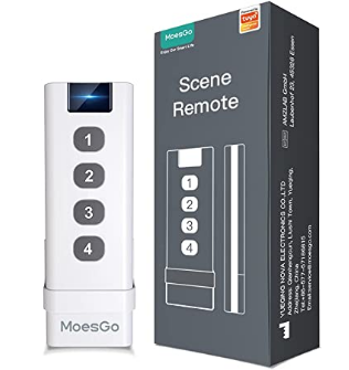

Moes 4 button scene switch
Hi can anyone help with this remote ... I try to pair to HE (C8 Hub) .. It seems to have paired, but i'm not able to make a physical press on the buttons to activate anything,,, or the other buttons won't pair. I'm using https://raw.githubusercontent.com/kkossev/Hubitat/development/Drivers/Tuya%20TS004F/TS004F.groovy... it populates when I seem to have paired the remote ... I can do a digital press and in the events section I can see the responses from the buttons that were pressed.
Install the ABC Button Controller. Works great. I have 3 of these,
If you enable the Debug logging, then remove the batteries for 10 seconds and put them back again - do you see anything in the live logs?
If not - your device was not paired successfully to your C-8 hub.
Use the Double Luck voodoo to pair this Zigbee 3.0 device directly to the hub.
Thank you so much for responding ... I will try soon and let you know the results, Greatly Appreciated!!!
I would like to thank both of you guys!
The Double Luck Voodoo and the Advance Button Controller did the trick!!
As the saying goes..."Awesome Sauce"!!
I'm very excited this works... Thanks to both of you a Million times over!!!
