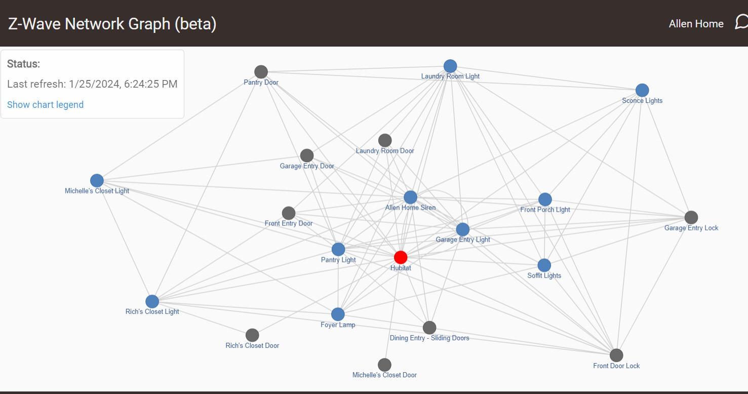

You need to add some mains powered devices so that the sensors have routes back to the hub. You may have created Z-Wave ghosts if you have failed pairings. Please post screen shot of your Z-Wave device table. Some older Schlage locks won't work well, if at all, with Hubitat.
Also review this:
Everything you mention sound like battery devices with no Repeaters mentioned. If the devices are in close proximity to the Hub, you can get a Direct connection, especially with the Antennas on the C-8. However, just a little too far or home construction materials might reduce the effective distance.
Please try Joining some mains powered devices, starting close to the Hub and working outward. Once all of those are joined, battery devices can be Joined.
Locks are tricky because the techniques Manufacturers use changed over the years. Initially they used "Whisper Join" to prevent a security issue. More recently manufactured Locks don't use whisper, but they don't do NWI (Network Wide Include) and they still insist on being close to Join. Then they are fine because a Beaming Router (virtually all modern mains powered devices have this feature) will get used.
I advise that you always begin a device Join activity with an Exclude from the Hubitat hub. If the Hub can exclude, it's a lot more likely to be a successful Include. An Exclude confirms that your hub, wherever it's located, can communicate to your ZWave device, wherever it's located. You should see an "Unknown device Excluded" message and you can go directly to an Include. Partially included devices don't work and quite often cause mesh instability and the symptoms you report are pretty similar, which is why we want to see your Device Table. :smiley:
Here is the DEVICE GRAPH. Sorry, I didn't mention that I did have serval light switches installed. Lights are working great. I have other sensors that working flawlessly as well. Still having issues with the Aeotec DSB29-ZWUS and Everspring contact sensors. Also, both Locks are working fine. I just can't get the LOCK CODE MANAGER to work with the Kwikset lock. After I get a few more swiches installed, I'll try to re-pair (learn in) the Kwik set Lock again,
