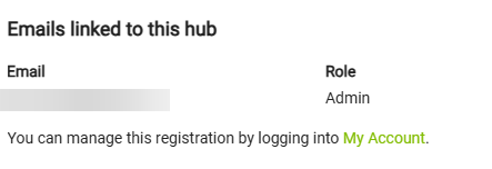

You can also go to Settings > Hub Info and at the bottom it should show if/where the hub is registered

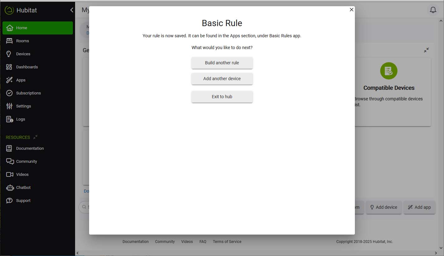

When I ran the setup process and it finds the new hub and I select it it is supposed to run a setup wizard. It is not supposed to go and directly dump me into the console in the middle of rule maker like the following image...
Setup wizard failure|690x398
Something is seriously wrong with how the setup wizard gets triggered.
BTW - The above image is not from my attempts to correctly migrate my C8 hub from the C7. This image is from the C7 after I did a hard reset so I can use it as a development box. It is doing the exact same mistaken process.

What I'm seeing now is hugely different from what the correct setup process looks like. Something is broken and the correct setup process is not being triggered.

"This" is running through the basic setup wizard that starts from "go.hubitat.com" and it doesn't ask if you want to restore or continue with for your login creds to register the hub.
Instead it goes directly into the console page into the basic rule maker.
OK, but if that happens after a full reset (or even a soft reset), that's not something "to be documented" -- it's a problem, and one I don't think I've seen recently (unless your browser is auto-completing some URL?).
I'm documenting it so support can chase it down. It is absolutely consistent.
The weirder part is I've found a repeatable workaround: Not using the online wizard and just browsing directly to the hub's address as it is booting the first time. It shows the same URL as the failure that goes to the Basic Rulemaker page.
Weird. It is something in the referral from the web to the local address.
