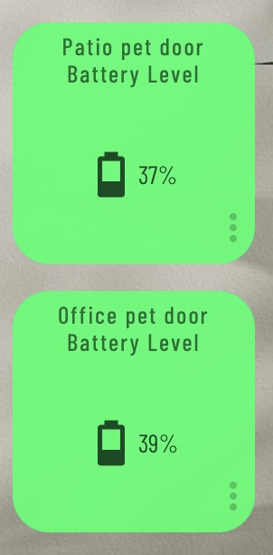

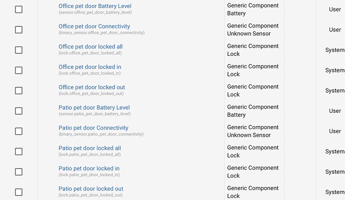

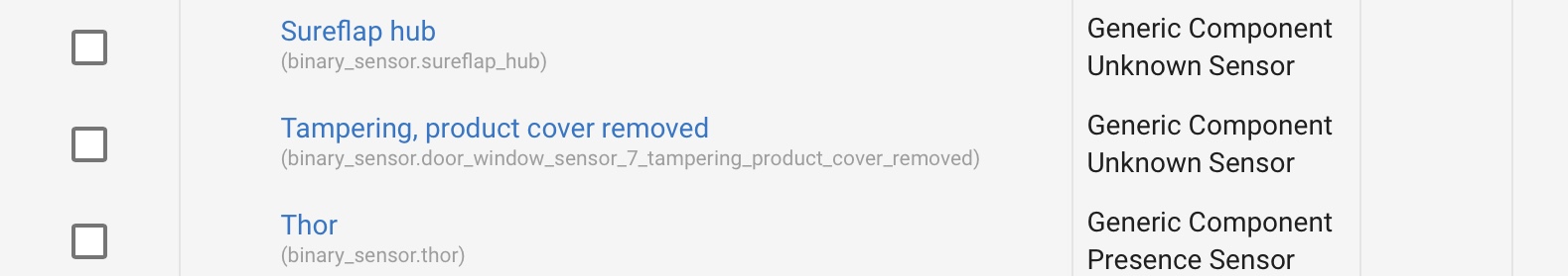

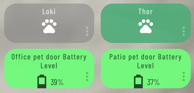

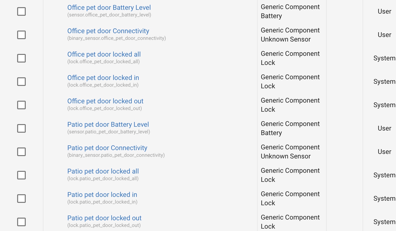

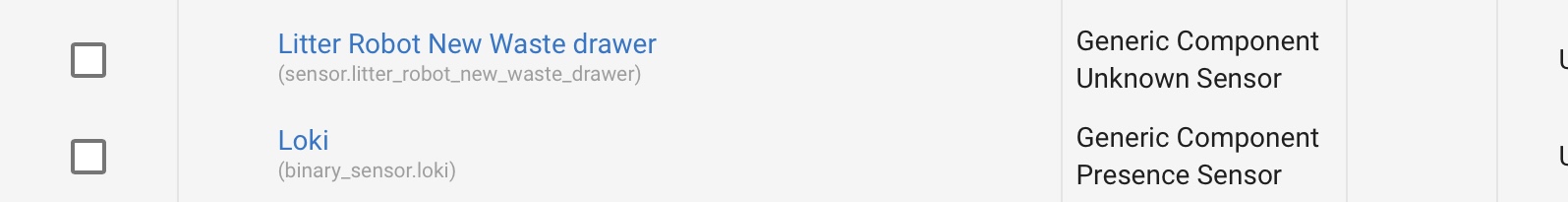

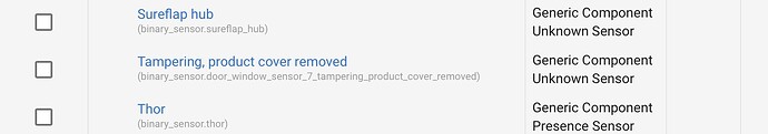

Here are some screen shots of the devices on dashboards and of the devices page:

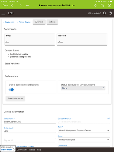

Here is what one of the pet device pages look like, which I use for presence sensing:
As you can see, I’ve got two SureFlap pet doors on my SureFlap hub.
Anything more that you would like to see?

Works with both. That’s the reason for the variety of Lock push buttons (see screenshots of devices). Not all the doors lock the same way. It’s really well done.
