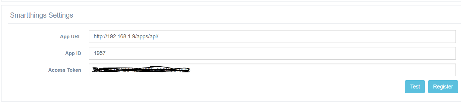

Can you go to mi connector web settings page to click the test button for app?

yes HE driver installed, i can see if the vac is cleaning ect in HE but i cant issue commands to the vac from the driver
none of the controls in the driver seem to work.
