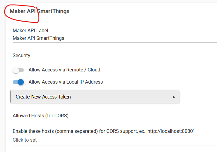

I’m using an old SmartThings hub mainly as an integration broker. It exposes Meross, Tuya and a few other awkward ecosystems into Hubitat via virtual switches, using SmartThings Mira / CStup Edge Drivers with Hubitat’s Maker API.
SmartThings has a much broader consumer integration ecosystem than Hubitat, while Hubitat is architecturally leaner and more functional for local automation.
This effectively stitches the two ecosystems together: SmartThings handles the messy cloud/vendor integrations, while Hubitat remains the local automation engine. For my use case, that is far easier and more reliable than mucking around with a collection of relatively unstable community drivers, at least as an interim step until the equivalent integrations become available in Habitat.
